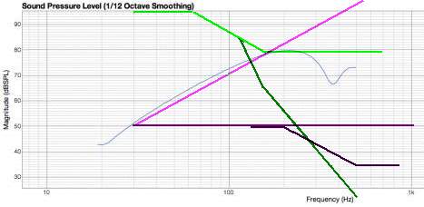

Your way of EQing a dipole is not the usual one afaik. You start with a 12 dB/oct shelving filter at 96 Hz. Obviously this is much too weak. Most others would start with the crossover low pass at 30-50 Hz and second or even third order. You first want to get the response flat from the lowest target frequency  up to the dipole peak region. This way all peaks higher up get much more attenuated than with your method. The shelving filter would only be a second thought if you want to cross over lower than at the natural roll off of the H frame into the first dipole dip.
The filters of the DCX do work as good as they should and they do have enough cut/gain. But they have to be used with a good strategy: Start with the more powerful filter and adjust with the less powerful one - not vice versa.
Can you spell out that strategy in more detail for me? I would be happy to improve the setup.   :)
To clarify, in my understanding with my existing setup I get full output at bottom end, reducing to -15db at 96Hz with 12db/octave HP EQ ... and I apply LR 24db/octave crossover above 110Hz.

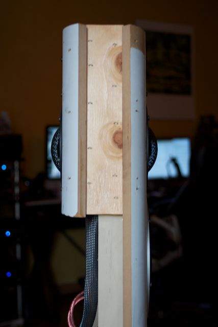

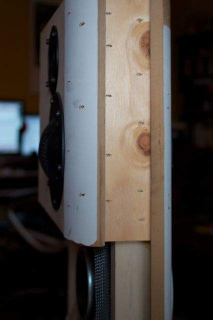

I'm really curious about the alignment you selected for the two mid woofers, the dome midrange and the tweeter. It looks to me like the acoustic centers form a perfect arc, but maybe that just worked out as such. Did you calculate their relative distance based on frequencies?  Just curious. When I experimented with offsets in my current configuration, the measurements showed only a small difference off-axis. With my previous config, (not coax) it was larger.
Despite any real proof that the effects of baffle diffraction are well understood and can be modeled accurately, I choose the locations of the drivers and size and shape of the baffle based on may hours of extensive baffle diffraction simulations in Excel Spreadsheets to find the configuration that would have the least possible negative effects of the baffle.
Hence the 3" rounding on the edges of the baffle, the angled side and varied driver distances from the edge as you can see.
I doubt that the baffle works exactly like the simulations said it would but you can see the dip at approximately 6000 off axis was predicted. Otherwise the off axis measurements seem pretty good. I think there is one substantial dip on the other side due to the proximity of the 2" to the close edge. If I did it again I might do that one a little differently.... then again I might be tempted to do without baffles entirely.  :lol:
I put all the drivers as close as possible together. The are almost all touching.
After mounting everything and getting the system up and running I looked at the time delayed alignment of acoustic centers:
I measured the distance of the cone to a point in space near listening position to confirm that the time alignment settings for each driver were set as accurately as possible. Also delayed ALL the smaller drivers by almost 6ms to match the delayed impulse response time of the big 10" drivers. The time alignment had a much bigger effect on the sound than I ever imagined it might.
The parabolic layout was kind of just a coincidence. But it made sense based on that layout to use the side where the drivers were closer toward the outside wall because it might have the least output. (It definitely sounded better that way but I can't say why for sure) I suppose part of the reason they sound nice _could_ be that nice arc which makes for kind of a natural alignment in the listening position. Coax would obviously provide better of access phase response.
Here are the spreadsheet simulations I ended up with (I won't bother showing the previous 19 examples I didn't use.   :roll:  )
Baffle configuration #20 on axis
Baffle configuration #20 @ 30degrees on left
Baffle configuration #20 @ 30degrees right

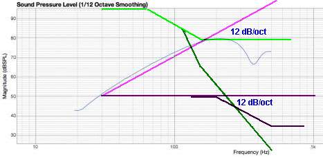

Above strategy of yours is the green curve - starting with the (light green) 15 dB shelf filter and moving over to the (dark green) cross over filter. The dark green line is including the part of the light green filter above 110 Hz:
I recommend another strategy: Start with a 12 dB/oct lowpass crossover at 30 Hz (or wherever you find appropriate). This would move everything along the lilac line to the level of the dark lilac line - compensating the dipole rolloff very well. After that you could apply the brown shelf filter at 310 Hz to subdue any remaining ondulations above 200 Hz up to another 15 dB.
The top end of my green curve (the 12db/octave -15db cut) ENDS at 96hz instead of 150Hz. So in my estimation, it would start at about 40hz wouldn't it?
Thank you for the clarification. The strategy you recommend does seem to make some good sense and I can try that... but I always thought it would be preferable to use 24db/octave at required crossover frequency.
I will have to test this out and report the results here. Thanks for the suggestion.
I thought that 96 Hz was your input number for the DCX EQ. If it is the end of the shelf, both filters would merge at the right point, and your strategy would follow what SL shows in http://www.linkwitzlab.com/proto.htm#PW1. This would be valid of cause, but it would not allow to move the cross over to higher frequencies.
From 200-500 Hz both of my (cascaded) filters sum up to 24 dB/oct  :). Look at the blue 12dB/oct marks:
At 500 Hz we should be down about 30 dB. I don't care much about the return to 12 dB/oct above the 500 Hz mark.
Indeed I have tried to follow Linkwitz and I think I'm as close as I could get with the gear I've got. I tried various tests using the filters you proposed and the results are so very nearly the same it is surprising.
This test shows in green my traditional setup. ( -15db 12db/octave at 96Hz + 24db/octave LR @ 110Hz)
Both red and yellow use -15db 12db/octave shelving filter ending at 223Hz.
Red uses Butterworth 12db @ 50Hz crossover
Yellow uses LR 12db @ 66Hz crossover
Group delay, distortion and all the other characteristics were so similar the differences are not notable. Group delay and/or phase improvements are probably the only place that substantial improvements could be found. Cascaded filters and Phase Linear EQ could perhaps offer some improvements.

1. The delay I have set on my 6.5", 2" and 1" drivers by 6ms is to make them line up with the delayed response of the 10" subwoofer. This delay in the response of the 10" is the same regardless if listening from the front or the back.
2. The delay of my 2" and 1" are relative to each other and the rear baffle is the same as the front baffle. So, indeed the delay DOES make the acoustic centers line up. These 2 drivers are NOT open back. I have 2 more drivers the same mounted on the rear baffle.
3.  The delay of the 2" and 1" relative to the 6.5" is still useful because the speaker whether viewed from the front baffle or the rear baffle, the cones of my smaller drivers ARE physically forward of the larger driver.
Here is a side view picture that better illustrates the physical offset of these drivers.
I would agree with him 100% that his conclusions are valid with regard to multiple open cone speakers on an open baffle. (i.e. 8", 6" and 4" open back cones) in which case one should obviously physically align the acoustic centers rather than use time delay.
In conclusion, I am not delaying the 6.5" relative to the physical offset of the 10" but rather I am delaying the 6.5" to compensate for the delayed impulse response of the 10" driver.  If I had not introduced the 6ms delay on the 6.5" midrange, the offset when viewed from the rear would be 6ft - 8" and would still have over 5ft+4" mismatch.
Technically he is right, my delay on the 6.5 relative to the 10" is not quite as accurate on the rear as it would be on the front but I submit because a 6ms delay is equivalent to almost 6ft and I would rather the front response match at the front and not worry about the remaining 8" physical offset when viewed from the rear.
