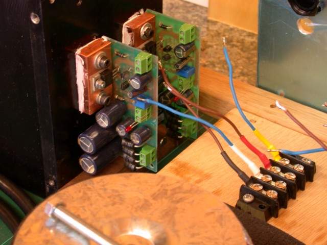

The PH regulators PR3G2-12 (12volts positive) and NR3G2-12 (12volts negative) come with a nice lump of copper to which the main regulator is clamped. So the second heatsink is drilled / tapped (3mm is fine) to take both a -ve and +ve regulator.
The way I had to mount them (vertically) did give me some problems in connecting them to the transformer and adjusting the regulators, I had to be careful with the screwdriver when doing the adjustment. It would make more sense to have the regulators horizontal - next time!

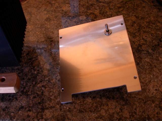

The front panel has only an on off switch - there are two LEDs on the regulated power-supplies which could be wired into this panel if required. As I am going for perforated ally sheet on the top I will get a nice glow from inside the cases. The cutout at the bottom caters for the transformer wires - primary and secondaries - needless to say they are well rounded.

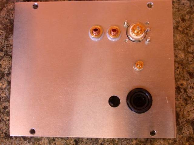

The rear panel has a mains inlet and should have a fuse-holder, unfortunately due to slight miscalculation it would have interfered with the regulators. So I will fit an internal fuse. :duh:
Also on the rear panel are a phono input socket and loudspeaker posts.

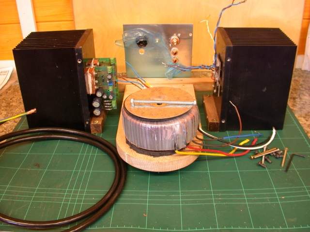

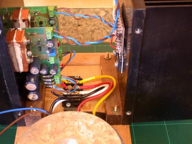

« Reply #5 on: 13 Oct 2010, 08:06 pm »

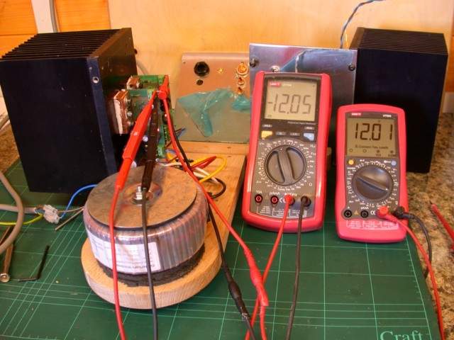

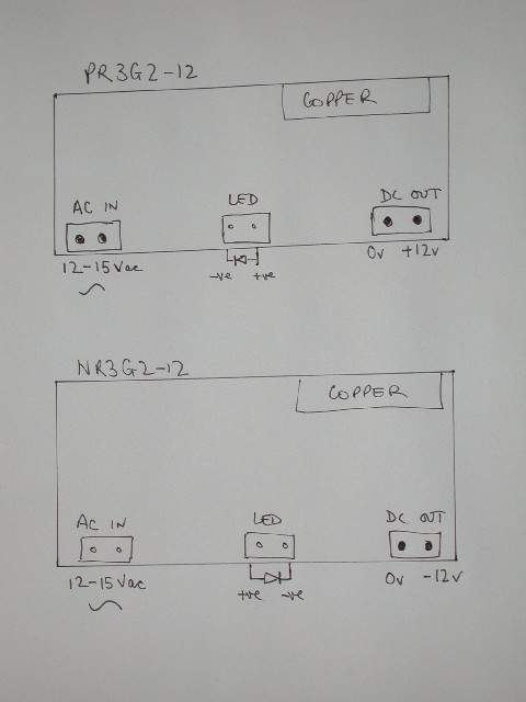

First a diagram of the regulators - inputs / outputs / LEDs

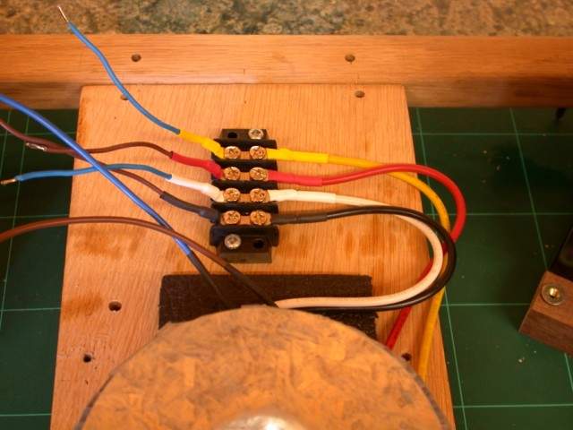

OK, the transformer is bolted to oak base, note that it will be outside the heatsink case.
A four-way connecting block joins the transformer to the AC inputs on each regulator. The leads from this transformer are 0-15 0-15 Red-Yellow Black-White; 0-240 Blue-Brown.
The Blue goes to the bottom connector of the AC connectors and brown to the upper connector - or the other way round! It does not matter - just make sure that both regulators are wired in the same way. The LEDs are connected - long leg is the positive! The regulator heatsink is now bolted to the base as well.

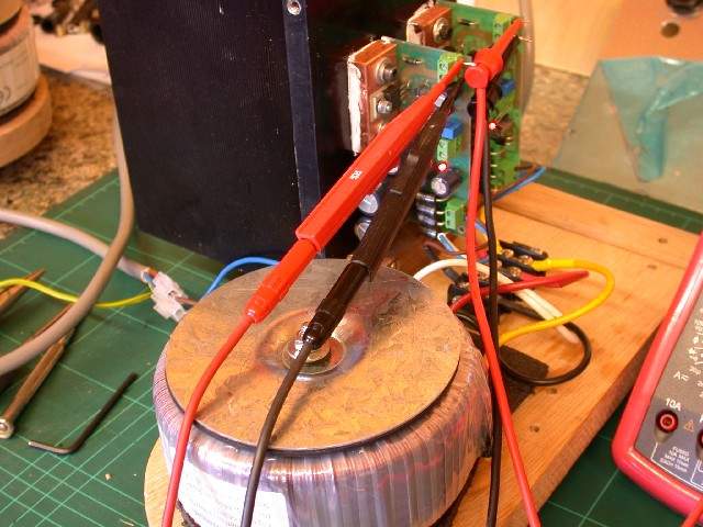

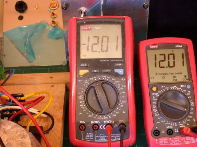

Before going any further the output voltages on the regulators are checked - I connected to the mains via a plastic block (chocolate block style) as a quick and easy method,
and then adjusted to give +/- 12 volts; it should be noted that the voltage takes a few seconds to rise to the required level, so let it settle for a few minutes before using the pcb mounted pots (blue) to slowly adjust to +/- 12 volts, after each adjustment leave for a few seconds to settle and so on. As you may notice mine eventually settled at 12.01 volts.

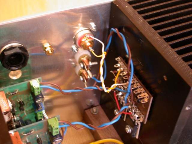

Now the amplifier heatsink is bolted to the base and connected to the appropriate regulator outputs - re-check that the +12volts and -12volts are connected to the correct outputs. It would have been better if I had used 4 different coloured wires - but I did check a few times before switching anything on! BLUE is always 0 volts BROWN being +12 or -12 volts - yes different coloured wires would definitely be better.
Then the rear plate was bolted to the two heatsinks and the phono input soldered and the speaker leads bolted to the posts - I did this because my soldering iron could not heat that very large amount of copper, this could be why Cardas have thoughtfully drilled a hole in each post :green:

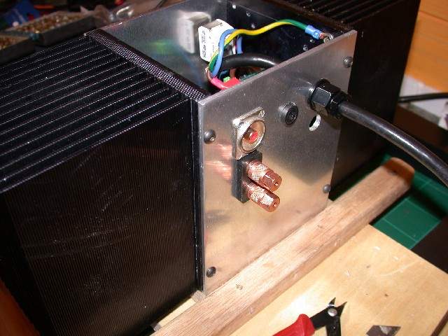

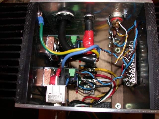

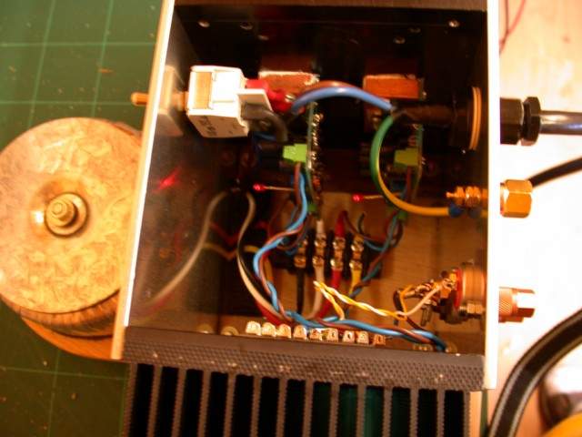

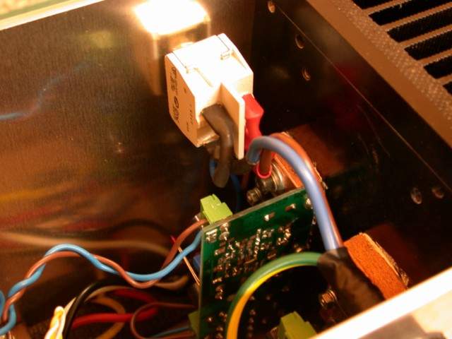

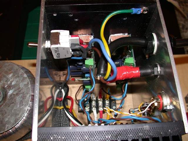

OK - connecting to the mains.
The transformer wires are connected to the switch - I always switch both the live and neutral - just to be sure! I have used heatshrink to cover the terminals as much as possible.
A nice beefy mains cable (Belden shielded 3 core 19364) is fed through the gland -both the neutral lead (blue) and the live (brown) are connected directly to the switch. Again heatshrink is used on the switch terminals.
The earth lead is terminated with a tabbed washer and attached to the earth post on the rear panel.
So what about the fuse I hear you say?? Well I was going to have an internal fuse, but at this point in the build I changed my mind and felt it would be better to go with the original idea and have a case mounted fuse holder. So the earth post was sacrificed - the hole was enlarged to take the fuse holder which this time did not interfere with the internal boards.
The live wire was cut and soldered to the fuse which in turn was connected to the switch - a safer method and now easier to replace any blown fuse. I am currently using a 2amp slow blow fuse and there have been no problem.
The earth is now connected directly to one of the heatsinks.
Switch on and two little red eyes appear inside the case, all is working well with both amplifiers so now I can finish off the case. this will involve making the transformer disappear (somehow) and some perforated aluminium sheet will be cut and screwed to the top of the heatsinks to stop prying fingers but still allow the glowing leds to be seen.
