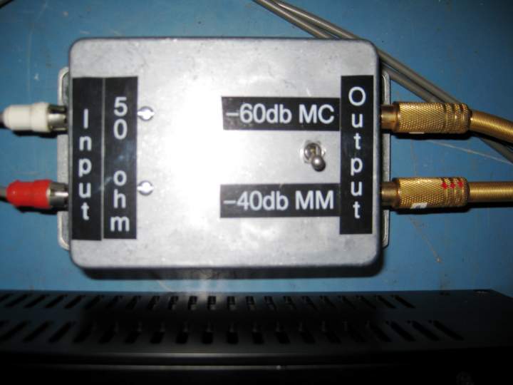

 Never having devoted this much time and effort to a dedicated phono stage , it occurred to me that I had no way to accurately test it for correct operation. Sure, the tubes light and the scope shows that a signal is passing through and being amplified but what of the accuracy of the equalization?
 The Hagerman RIAA2 kit.
 I think this tiny piece of test equipment is absolutely necessary for the completion of this (or any) phono stage. The only suitable substitute I could think of would be using a test record and your vinyl front end but, in all honesty, that is going to be far from easy and may not be all that accurate. Another aspect of this method is that it would be difficult to isolate the origin of a problem: "Is it the unheard phono stage? Is it a cartridge problem? Alignment? Stylus?" Too many variables ...
 The point is, one just could not be sure.
 The RIAA2 is an ingeniously simple circuit that alters an input in a manner that simulates the reverse of the RIAA equalization. Feeding this output into the input of a phono stage should give a completely equalized output. That is to say that any signal injected into the RIAA2 and then through the phono stage should produce an identical amplified signal out.
 Elegant!
 Recommended!
