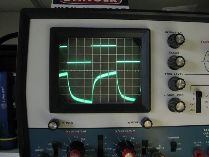

poty,
I am injecting a 1Khz. square wave sourced from a Heathkit IG-5218 through a Hagerman RIAA2 (that's depicted in the picture) at .02V p-p. (Top trace) The bottom trace is the output at 2V p-p.
 The output of the RIAA2 is nearly a square wave, showing a slight slant owing to the reverse equalization.
 I think I've made a gross error in component placement. Mistakes happen. I just haven't caught it yet, nor have I had an extended opportunity to concentrate on it. This is a busy, social time for us and we all understand the penalty one pays for withdrawing from the family during these times.

Do you have the tubes in the  right sockets?  I seem to remember similar waveforms when an 12AU7 was accidentally placed in one of the 12AX7 sockets.

poty,
Slight slant after the equalization??? -20dB in the low-frequency, +20dB in the high-frequency! The form should be greatly affected!!!

Could it be that the test equipment requires calibration? From what I perceive from poty's comments, the expected square wave is wrong for both the Cornet and the iRIAA.
As for the lack of Bass you mentioned, that could be off-value caps in the RIAA section of the Cornet. I understand the correction curve is very sensitive to the value of the caps used.

 When I screw up, I usually do it as well as I possibly can. I also make that same mistake in both channels. Matched no less.
 Poty hit it, As did jameshuls.
 The problem began late one evening when I ordered the components for the Reverse RIAA filter. Instead of 60.4 and 536 ohm resistors I ordered 60.4k and 536K. I then slapped it together in short bursts, never giving it the attention it deserved.
 "It's a tiny, passive filter ... what could go wrong?"
