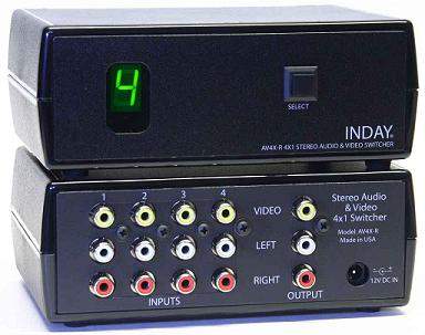

Those are pretty much your options.  Since you are using a tube preamp in addition to an HT preamp, you are obviously doing so for the purity of sound and/or for the tube sound for 2 channel listening.  I wouldn't feed the tube preamp into the HT preamp circuitry and additional volume control if I had the option of using a switcher.
A reasonably priced switcher is the Inday AV4X-R for $129.  It uses a 12VDC external power supply, but that is only for the remote control and display, the switching circuitry is passive.
Steve
