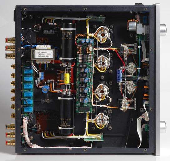

srb
Re: Point to Point or Printed Circuit?
« Reply #15 on: 28 Aug 2010, 02:02 pm »
Blair,
Here is another hybrid that I mentioned earlier, a PrimaLuna integrated amplifier.  Point-to-point wiring, chassis mounted tube sockets and PCB's for sub-assemblies where it makes more sense.
Steve

I'm a big fan of the hybrid approach mentioned here (and shown in the Primaluna amp).  I think a well designed PCB is a great thing; keeps things where they should be, (hopefully) well thought out design, they can be done again and again the exact same way, etc.  The only thing I hate... sockets on the PCB.
I built the Tubelab Simple SE that Dave built  (actually even copied much of his chassis design) and I love that amp; I just hate the the sockets are wired to the board.  That's pretty much the only thing keeping me from building all the other amps Tubelab sells.
PCB's can be great things; use them for what they're good for and use point to point for areas where it excels.  Sticky to one particular design philosophy purely on principle is crazy.  Take the best of everything.
