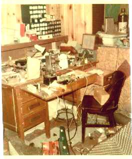

Hi Ray and all Audio Circle members.
When I studied basic electronics at Teccart Institute in Montreal, Canada in 1967 we were using Weller 100/140 watts welding gun, I still use one that I have purchased 30 years ago. (Good investment)
At that time, we only studied tubes and transistors were an optional course, which I did not take.

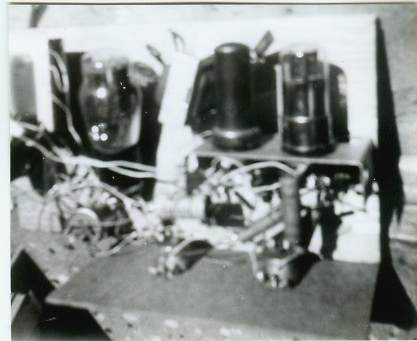

I did my first amplifier with salvaged TV parts mounted on a wood bread board. I've used a 6SN7, 6L6 (?) and 5U4 or 5Y3.
I had only enough parts to make a mono amplifier. It did work first time I turn on the switch and did not blow any fuses or catch on first. No need to say that the sound coming out of it was the equivalent of an intercom or a walky-talky…
That was my first venture into the wonderful world of electronic with tubes and I don’t regret it.
My work shop in my parent's basement.
My first amplifier, yes, I know, what a mess....

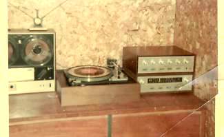

My first real sound system. It's also the system I've liked the most.
