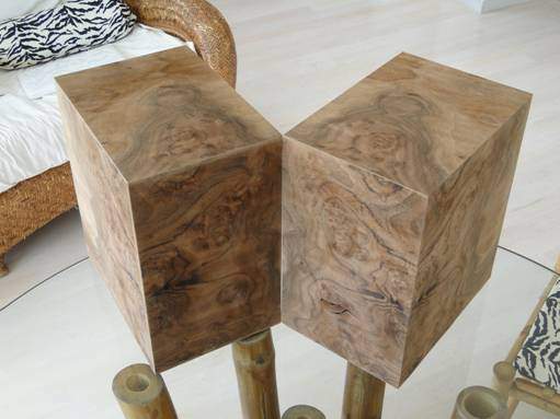

Well, to cut a long story short, I rediscovered how much I enjoyed listening to music about 18 months ago and got myself even more hooked when I set up a system at home.  Then I had an idea - building some speakers would be a great way to spend some time with a buddy of mine - and I've always found it much more meaningful putting my own sweat equity into things, so it would be a win-win. So I ordered some GR Research stuff and bravely ventured forth ...... having never done any DIY or woodwork before.
Well, wow .... this is a lot more work than I thought it was.  I have a new-found respect for cabinet builders.  As is often the case, I was a bit ambitious.  I got a pair of N2x flat packs thinking we'd whip those out quickly for practice before we set on a pair of Super-V's.  Many weeks later ..... we're still on the N2x's. Ok, we only spend about 4 hours every second weekend, but still.  Anyhow, we've got the veneer on and are ready to varnish ...... here are some pics.
Next is on to the varnish.  I'm hoping the coloration in the veneer really comes out.  Any advice as to whether I should varnish or cut the holes in the veneer first?

Great job Will.
You picked a really nice and interesting veneer.
Good luck in your next steps.

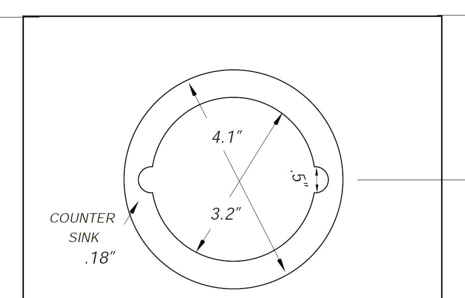

Thanks decal.  The holes in the cabinet are cut but I didn't cut the veneer before applying because I fully expected not to get the cut 100% right and being left with gaps.  The only really tricky bit is the cut for the tweeters because that cut has to be very accurate.  The baffles are already cut with the inset to accommodate the inset drivers but that leaves us needing to cut the veneer very accurately tracking to curve of the baffle-inset.
Does anybody have any advice as to how I can get the cuts for the tweeters done nice and cleanly?

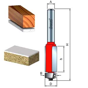

Really nice veneer!  You could just wet it a bit with paint thinner if you want an idea on how it will look with varnish.
If you want to cut the veneer to the same dimension as the hole you can use a router and a flush cutting bit with a bearing like this

Django11 has given you the tool to flush cut the veneer inside the cutout.  Good luck!

The flush bit will only get you halfway there with inset drivers.

I'm not sure I described the situation accurately in my original post, so I've revised it above.  The inset in the baffle to house the sweeter surround is has already been cut into the baffle.  What I have to do now is make sure I cut the veneer exactly flush with that pre-cut curve.  Given those circumstances it sounds to me like django11's suggestion would work.  Am I still missing something?

It all depends how deep the recess is. Does the layout under the veneer look like this?
If it does, then the countersink is only .18", a little shy of 3/16".
The bearing is thicker than the recess and the carbide cutter of the router bit will be above the hole.
And always cut first, varnish last.

It looks very much like that under the veneer Wayne.

Then you will either have to sand or route using a center pivot point unless someone who has done this before has a more elegant solution.

Yep, that's it. Grizzly Tools has a solid carbide bit for $7.25 but the bearing may also be too high.
http://www.grizzly.com/products/Solid-Carbide-Flush-Trim-Laminate-Bit-1-4-Shank/C1455
A hacksaw will not cut carbide and you would need a grinding wheel with a silicon carbide wheel to grind the bearing down to 1/8".
Back in the old days these cutters were made from high speed steel which is easy to grind.
