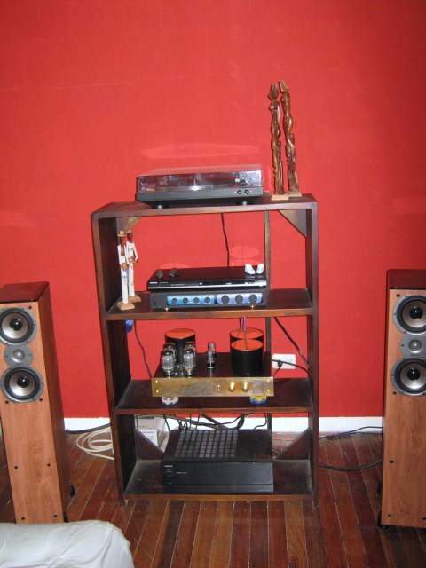

Ok here´s the question: I recently bought a JD801A amp, and i´m loving it, the thing is that i need it to handle mid and hi frecuencies, leaving the lower gap to a self powered sub, the electronic xover that i have needs that the integrated amp have a pre out and a main in to filter it, the matter is that the 801 doesn´t have a main in, can i use the tape in to achieve that goal?

Second, what inputs and outputs are available on the electronic crossover? I looked at the pictures of your amp and it appears to only have one selector for input, you would need a second selector to send the source to the fixed outputs then that would connect to the crossover and back into the tape input. Can you connect your sources to the crossover directly and select the one you want to listen to there? If so then you would just connect the crossover outputs to an input on the Jolida for the treble and mid frequencies and the bass output to your powered sub.

Nice feet socks !
The creativity of diyers are impressive.
Cheers, Gustavo

Good eye, Gustavo! Those are hackey sack balls?

Never hear of this balls through. Looks it is the very same by the images on Google. If someone is a handy man and wish show his skills, there is this tutorial link.
http://www.mahalo.com/how-to-crochet-a-hacky-sack

Well; the xover have two inputs and three outputs, one for each frequency range, in the fornt panel it have four selector knobs to cut the frequencies, and three volume knobs, idem to each range. So I can connect the TT and the CDP to it, but then are two issues, 1- I´ll have to use at least two volume knobs, 2- I feel that it will loose the spirit of having tubes preamplification
Anyway I think that I´ll need to buy a tube preamp, and then problem solved
And YES Jake and Gustavo, they´re hackey sacks, since they´re sand balls are quite good to avoid vibrations, and also they look kind of funny, whish at the end is the final goal of this hobbie, have fun!
I post a pic so you can see under the CDP in the second space fron top to bottom, the xover front panel layout.
