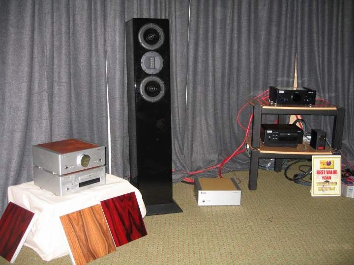

I just heard these at the Lone Star AudioFest and couldnt hardly believe the hifi sound these were producing. Later i found out they were not exactly N3's but a speaker Danny is working on for commerical offering. I dont know how different they are from drivers in the N3 but these things were produceing very nice bass and i had to ask the Virtue host if a sub was being impoyed. Point being these sounded great even without a sub. These were very "easy" to listen to. Danny would have to pipe in on the differences.

 And Nick77, thanks for that shot, gives me a good idea of just black... looks like it would fit in well on the Death Star.
