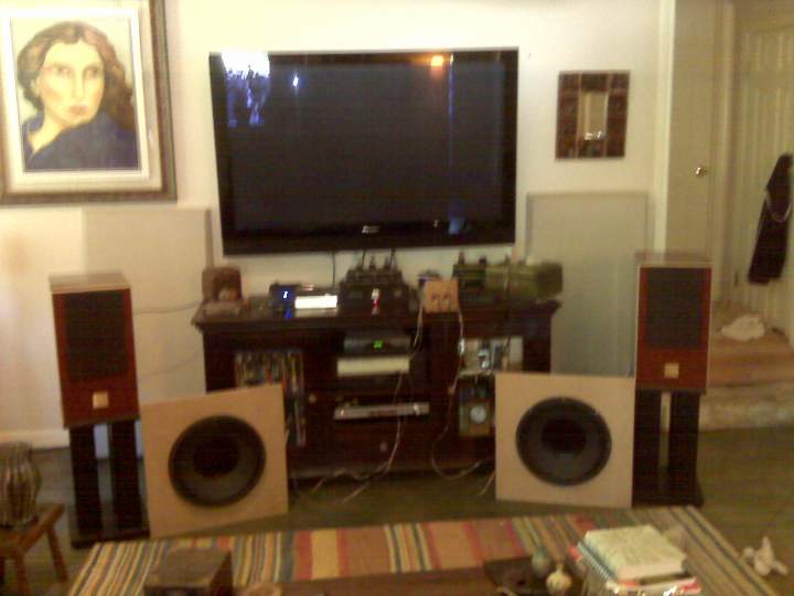

Six hundred dollars later and now I have completed (sort of) my OB bass system...not inexpensive, but it totally rocks.
Here's what went into it:
-2 Hawthorne Audio Silver Iris OB 15" Augies (used).

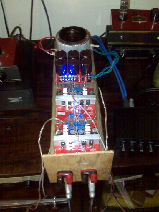

-Class D Audio 120 wpc amplifier.  Actually, the amp consists of two 120 wpc amp boards bridged.  So, each bass driver is receiving 240 watts.
-Reckhorn B-2 bass management system.
The system now looks like this:
Bolder modded Squeezebox III -> Burson Buffer -> Mapletree Preamp -> Red Wine Audio Signature 30 -> Omega Bipoles:  RWA Sig 30's line level outs -> Reckhorn B-2 -> Class D Audio amplifier -> Augies in open baffle.
I used 1/4 inch mdf panels cut in 22" squares for the baffles, per Bob in St. Louis' suggestion in another thread.  I used bookshelf brackets to stand the baffles up in an L configuration.
While my wife isn't particularly thrilled with the look or the size of the new speakers, I think they sound incredible.  They are replacing a Martin Logan Dynamo subwoofer, which has an 10" driver in a sealed box.  While the ML sub is pretty good for what it is, it doesn't compare to the new bass system.  Articulate, musical, and punchy are all adequate descriptors for the OB subs.  I'm not only amazed that I was able to put all this together, but am equally amazed at how it sounds.
Come to think of it, I have a pretty weird speaker set up.  The mains are single drivers firing front and and back in a bipole configuration and are now backed up by two 15" OB dipole subs.  The combo sounds very, very good to me.
The next challenge will be to put the amp in a wife acceptable enclosure and try and do something with the OBs that she will also find acceptable...maybe make stands for the Omegas out of them.
