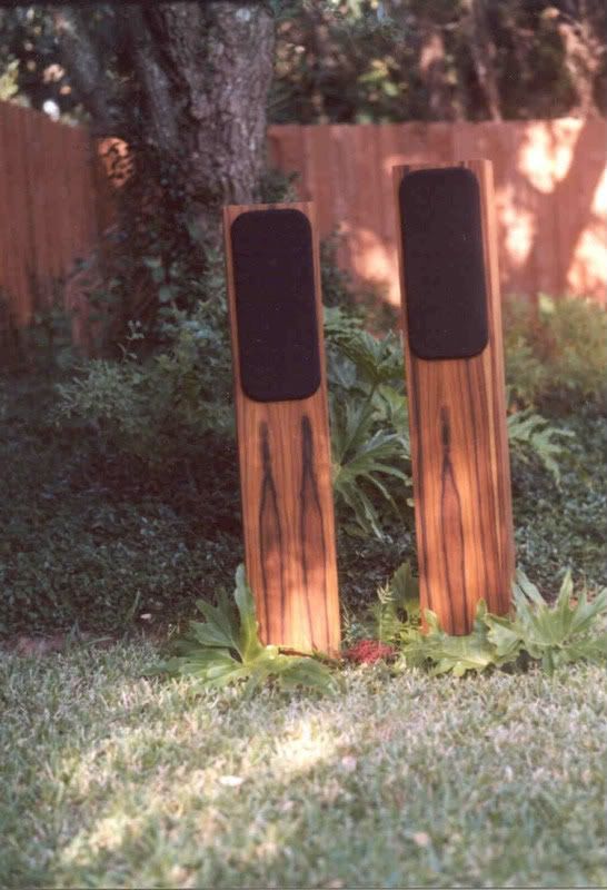

Ty, here's what A/V-3's look like in rosewood veneer (love that veneer).
Unfinished right after I built them:
Finished in my Danish oil finish:
[/img]

Eclein - Yes. I built the speakers shown in the photographs.
Hank - Your AV-3's in Rosewood veneer look great. Nice job.
