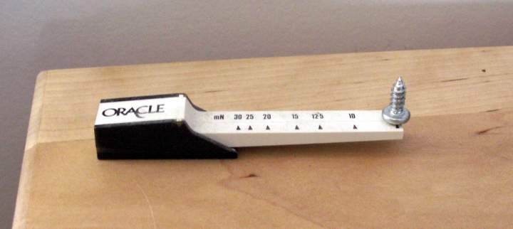

it is possible that one may want to use the "iterative tune by ear method", but do it in a precise manner, measuring in precise increments as you go.  if that's the case, than a properly calibrated digital tracking force gauge is the way to go....   8)
personally, while i do own a digital tracking force scale, (that came w/a calibrated weight set), i get perfectly adequate results w/one of these, tho i confess to not being able to notice any difference between, say 1.50g and 1.52g tracking force:
