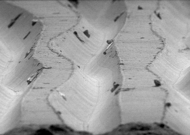

There is a lot of crap on the net talking about which channel is which. Some say that the horizontal movement of the stylus is one channel, while the vertical movement is another.
Here is a nifty photo of a record groove close up.
Wayner
mark funk
Re: LONGHORN GOLD1 AND GREEN1 CARTRIDGES NOW AVAILABLE!
« Reply #145 on: 30 Jun 2011, 09:28 pm »
Boy does this bring me back. I all ways had trouble setting up my table and most likey never had it right!
When they cut the master it only cuts in one plane, left and right or does it cut up and down too?
Wayner
« Reply #146 on: 30 Jun 2011, 09:34 pm »
If I knew more, I'd be cutting the masters. I wish we could all go on a field trip.
Wayner  8)
