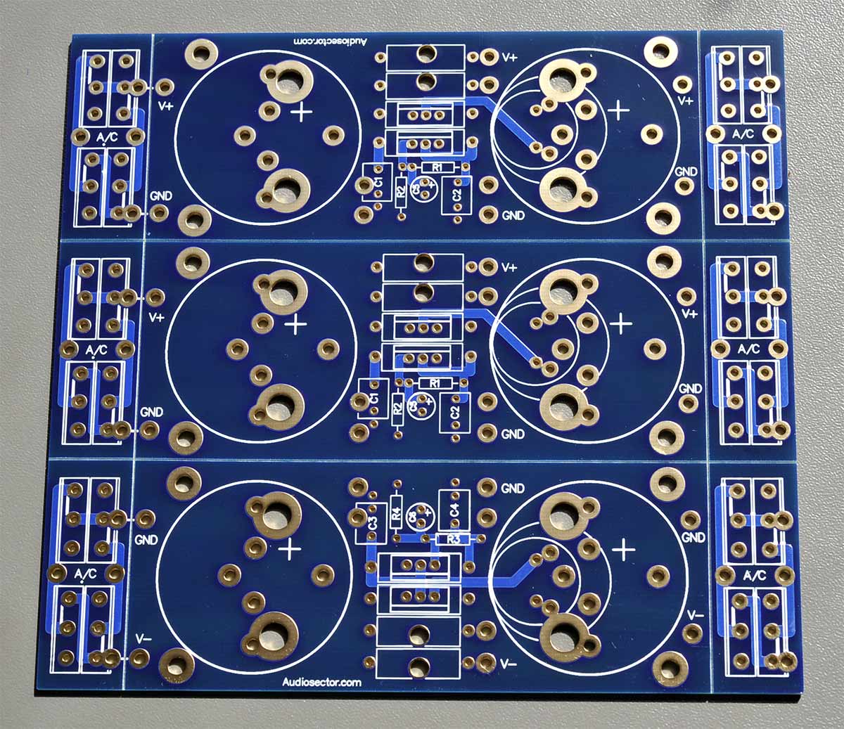

You can also get the Universal power supply board from Peter Daniel of Audiosector. It is also drilled for 4 pole capacitors if that's what you fancy. The price per board I think is $10.
Here is a link.
Anand.
