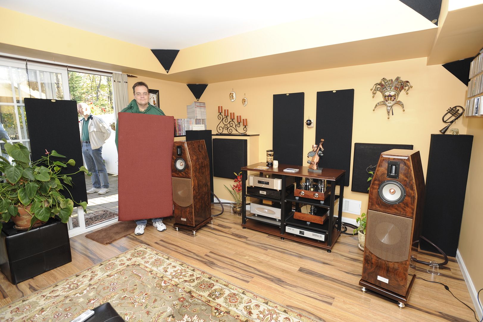

Be forewarned, I jest,,,,,,, but here's an acoustic idea straight from last weekend's NY RAVE gathering.  :thumb:
We'll even throw in Emil! :jester:
