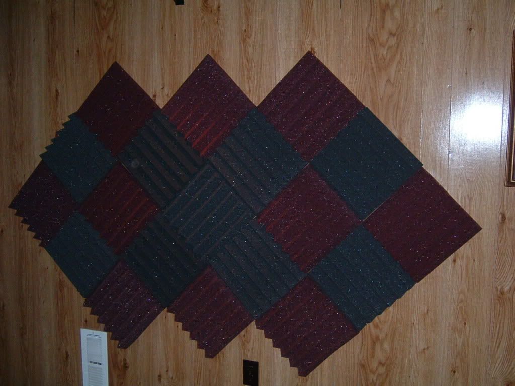

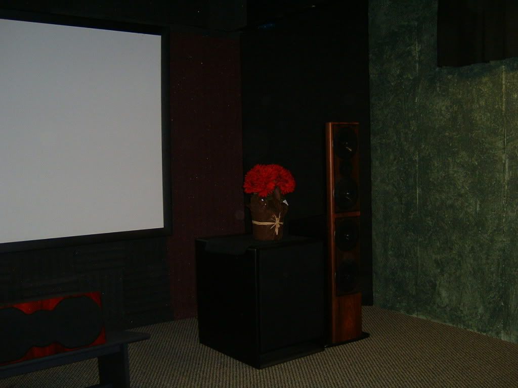

Here is a couple of pics of what I did so far for room treatment.  My lighting is bad for taking pictures.  I made the bass traps in the corner from ATSacoustics rock wool from their 2x4x2" cut in half then cut into triangles to make 24x24x32" triangles.  I made a frame then covered it with burlap, then used springs and hooks to keep them tight in the corner.  I then used the foam wedgies and put them on the front wall between the bass traps and all around my projector screen. From the foam panels left over, I made a pattern on each wall.  I have done nothing yet on my back wall yet, have been busy working late hours.
The bass traps really helped.  It sounds more even.  I have no test equipment to test anything, other than the audyssey on my Marantz 5003.  I'm using 2 X-tatik for main fronts, 3 x-cs for center and surrounds, and 2 MFW 15's.  All speakers are from AV123.
Any pro's or con's on what I have done, or should do?  LOL I am in no mans land, in western Kansas.  I either have to mail order or drive 250+ miles to get to a large city to hear anything audio related.
