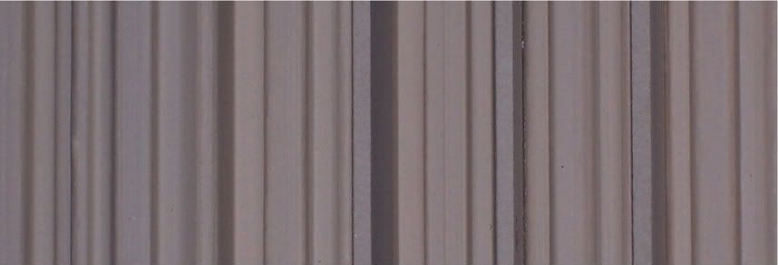

Glenn Kuras
  • Posts: 463
Re: QRDs QRDs come and get them
« Reply #4 on: 13 Oct 2009, 01:26 pm »
Understand and some people do that.  It does somewhat impact the upper end of the larger diffusion pattern but can be done.  In our big diffusers, we use a poly for the face of the wells instead.
Bryan
Here is a picture so you can see the poly built in.

bpape
  • Posts: 4465
    • Sensible Sound Solutions
« Reply #7 on: 14 Oct 2009, 11:56 am »
Hi Jake.
On the big wooden well diffusers, some of the wells have polys, some don't.  Jason would be the one to answer the reasons why - he designed them.
On the D1's, working with molds certainly makes things easier.  The one wider area is where 2 wells of the same depth are next to each other.
The advantages of the convex curves is that they don't have an upper limit.
Bryan
