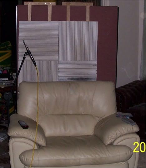

I have built quite a few
I have this one directly in front of me between the speakers, which is a five repeat seven prime
and have this one direct;y behind the LP, which is a rather more complicated one (pict given earlier in the thread) consisting of a five prime qrd nestled within a seven prime base, and a repeat of five panels
They are on temporary stands, which allows me to move them around and 'see' what happens in different positions. Once I know what goes where, I can then renovate the room and incorporate it all.
Here is a bunch of other ones I made, done as a 'proof' of my construction technique. A clone of the RPG flutter diffusor, again just set up on temporary stands etc behind the lp (since replaced by the difractal)

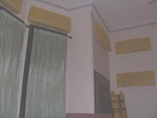

Max, yeah for sure I have tried just absorption. The room is very large (as you might make out from the photos) and very solid, walls are about two feet thick of solid masonry. So LOTS of echo yada yada. I always had rugs on the walls to help with that a small amount. For the last few years I have been finalising/building my speakers, and once they were done I then, just as an experiment, hung a few raw batts on the walls (I could hang them on thin string from the cornice all around the room.
I picked that photo for a few reasons, it gives an impression of the height of the ceiling (5.4 m, or seventeen feet if you are behind the times hahaha) and, apropos to our earlier explanation, you can see the missing bits of cornice that I need to repair...using the old timer trick I have adapted to qrd building!! A neat closing of the circle (oops, another little joke there haha)
Oops, another brag, another angle of the experimental bass traps (raw batts) AND the speakers that I have finished.
I have always maintained 'fix the speakers, then the room' ie the speaker/room interaction, and it was only after I had done the speakers that one day I decided 'bugger, just hang batts and see what results'.
