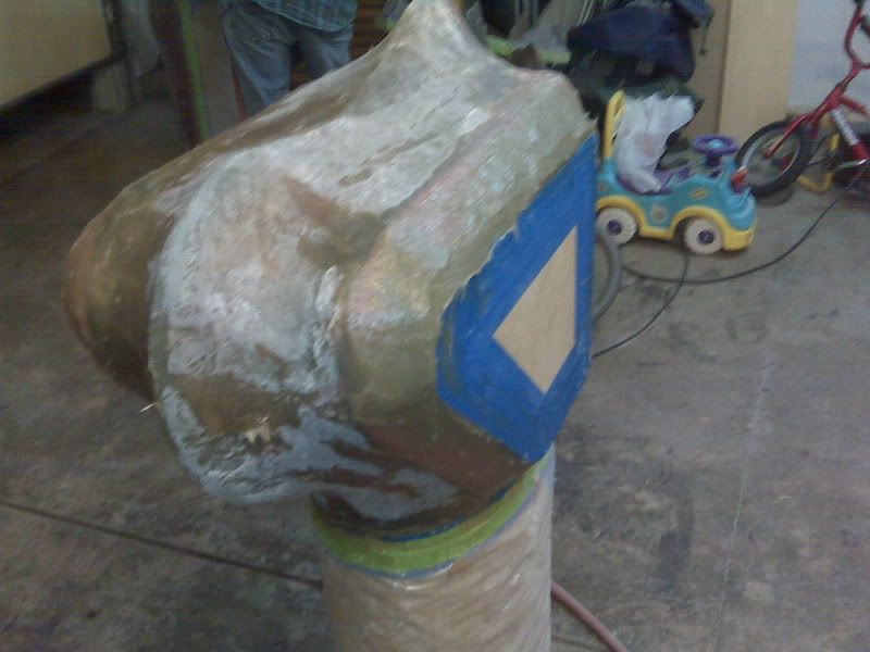

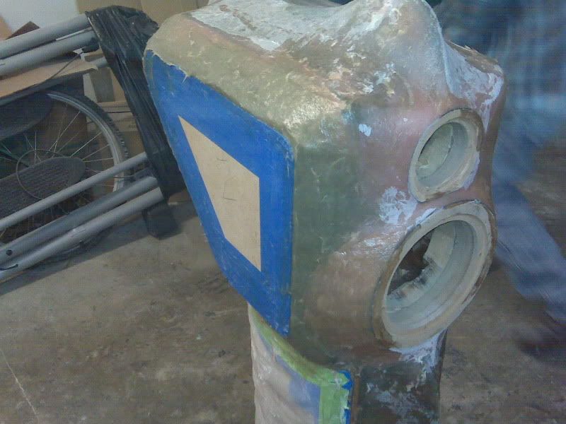

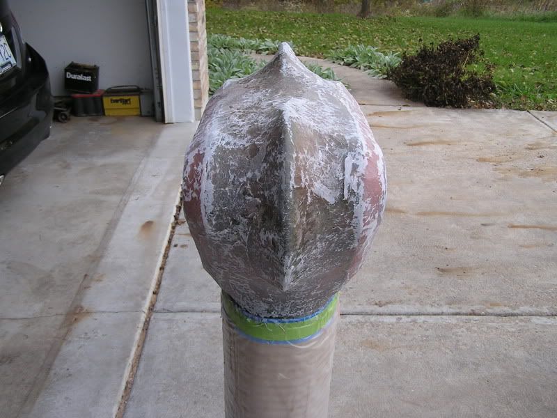

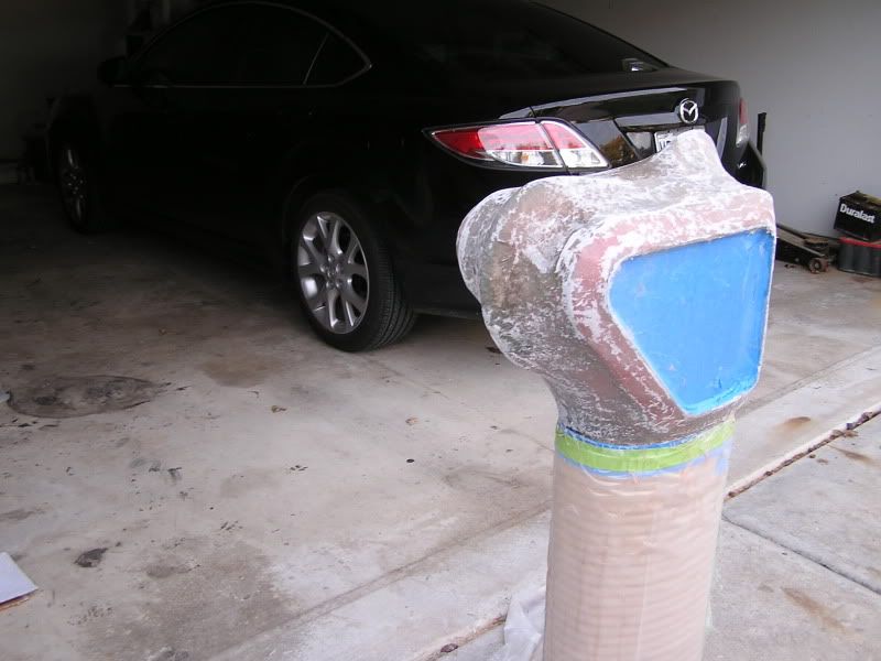

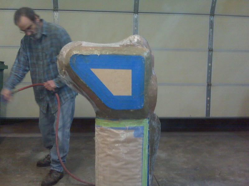

Got a little work done today.. 1 of them is entirely fiberlassed.. 3 layers of mat along with fiberglass repair paste to build up the transitions..
I did a brief once over with the angle grinder to knock down some high spots and rough areas and will start to shape it once I get the other one glassed...
Then duraglass.. spot putty.. then 2K fill primer..
DAMN THESE THINGS WEIGH A METRIC TON!!!!

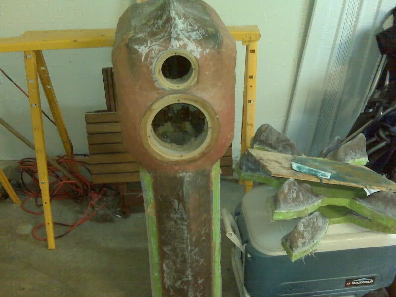

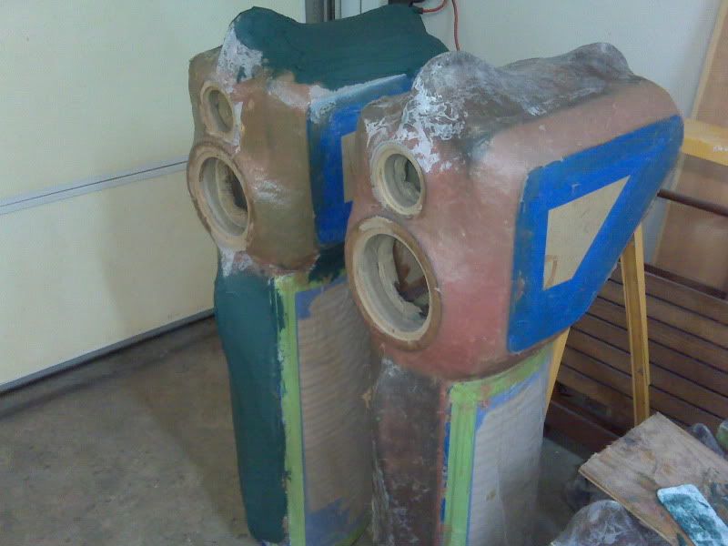

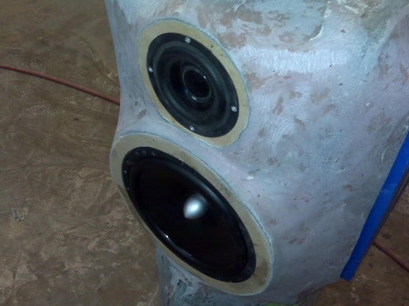

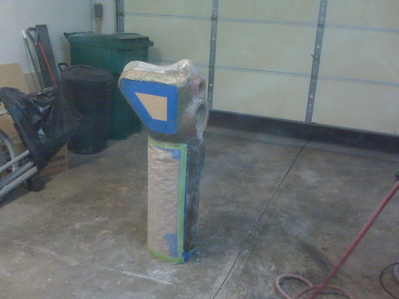

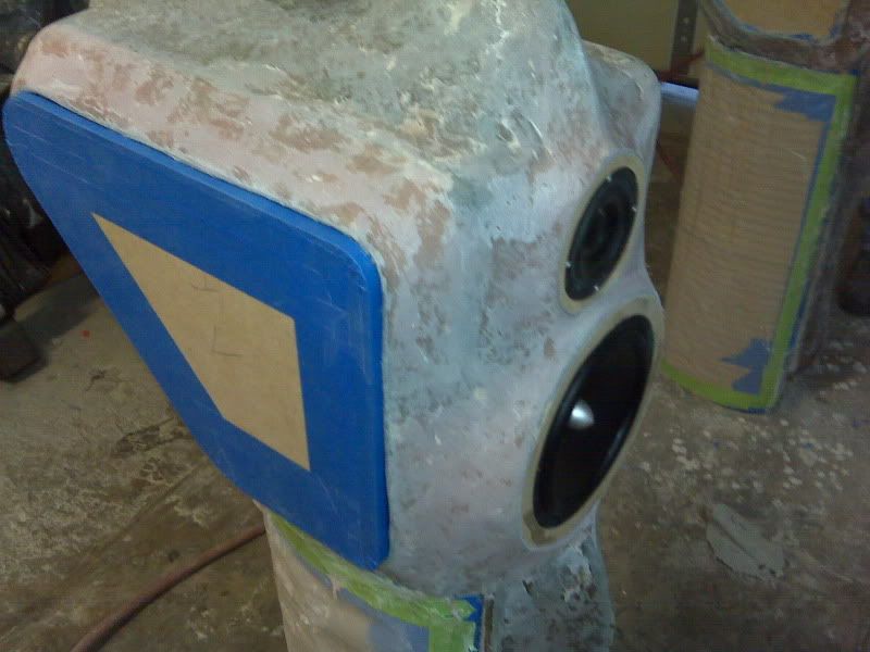

OK.. so had to take off these past 2 weeks due to some family health issues.. but FINALLY.. I get to work    :green:
So, what you see here is them being on the 5 yard line and almost to the point of filling/smoothing in preparation for painting.. As you can see.. fiberglass has been added to make all the transitions better and smoother. Also the side inserts that will be veneered to match the stands were also flushed in with fiberglass and will be removable for veneering.

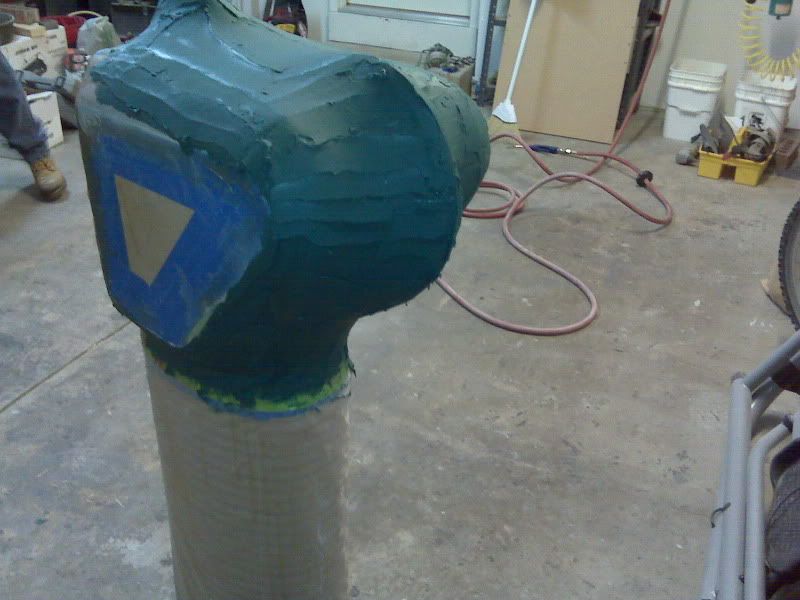

There are a million ways to skin a cat.. I typically like to use as much wood as possible and really only use the fiberglass as aesthetics.. but it does allow me to create unusual baffle shapes that do help in baffle step issues..
so.. I like to make my frame out of MDF.. 1/4 or 1/2 is fine.. treat the frame as the outer most dimensions or general shape creator.. I typically use lycra or fleece as a pull material for creating shapes.. you want something with a 4 way stretch as this allows you pull cleanly. On all the edges that you need to pull to, it is a good idea to run a rabbet bit across it as this allow the staples to sit at a lower depth and run run less of a chance to sand down to while smoothing for paint..
from that point, really saturate the cloth with resin and allow to cure.. once dry do a minimum of three layers of chop mat.. do a quick bush over with a 90 degree grinder using 40grit paper to knock down high spots and to do some small shaping. Then toss on a layer of duraglass and sand to perfection.
Finally spay some high build polyester primer and let sit for a day or two.. then guide coat and block away.. I stop at 200/220 and let my painter do the rest which isn't much

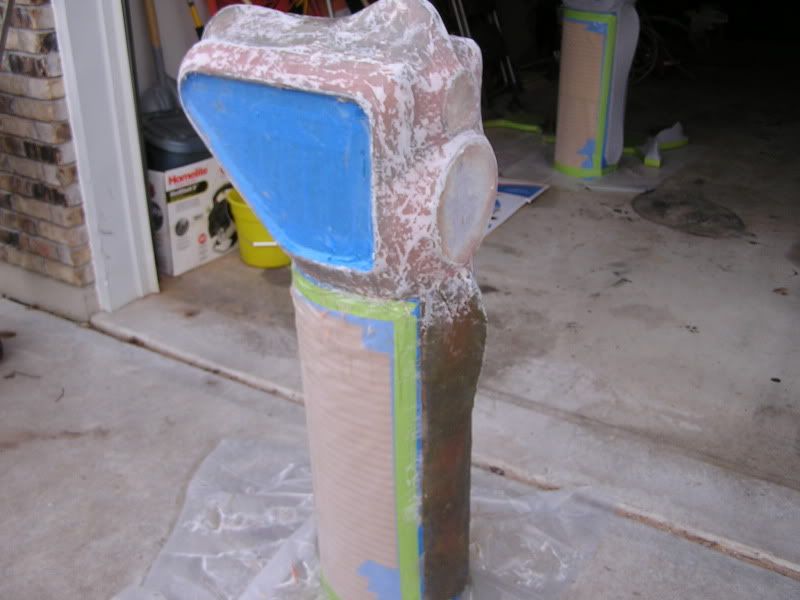

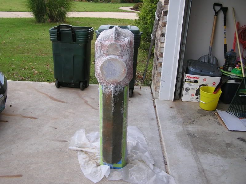

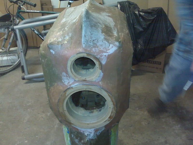

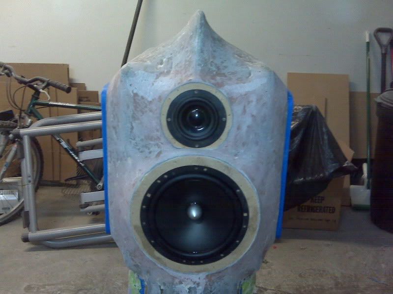

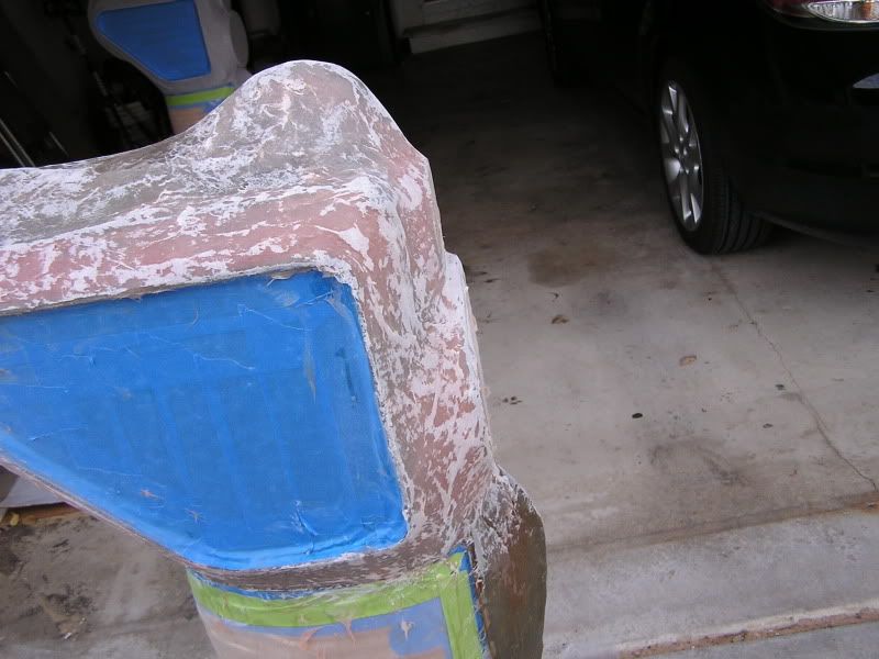

got some work done last night.. all the fiberfilling is complete on both pieces.. this means all the inlays and baffle contours are done. To me, this is a better solution then using duraglass only to build contours..
I did add duraglass to one of the loudspeakers and they will shape up better than expected..

« Reply #96 on: 5 Nov 2009, 06:05 pm »
Very Nice,
 How do you keep the two speakers uniform? Ar eyou using some type of patern or are your eyes really that good :lol:

Thank you sir Bill.
all of it is done by eye.. I do have some small pieces of card stock that I will use to make sure that the shapes are similar.. but I won't use that until I get to the next stage...
