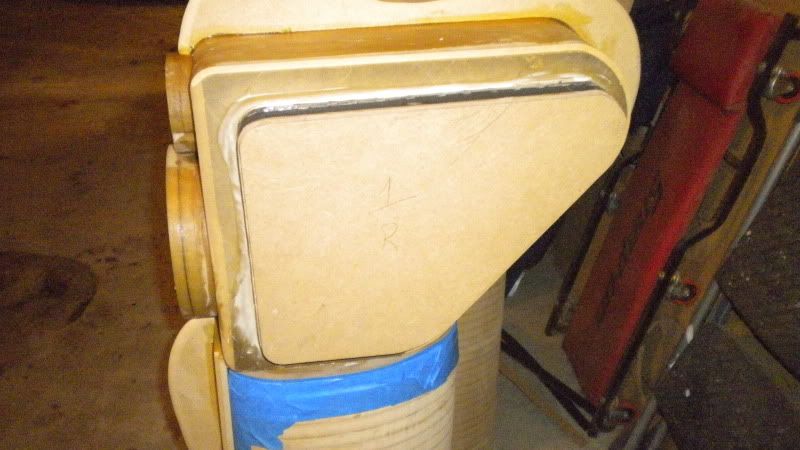

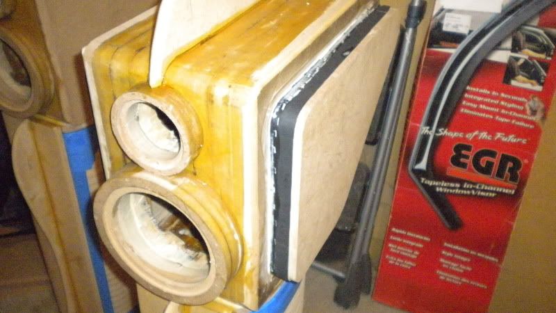

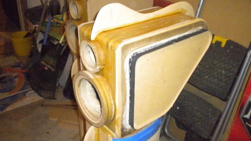

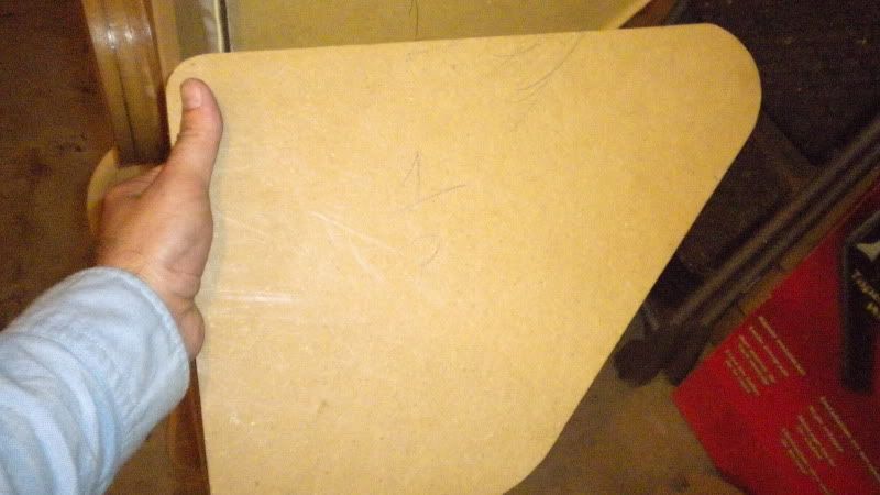

A few more things I can scratch off the check list..

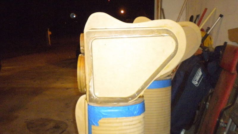

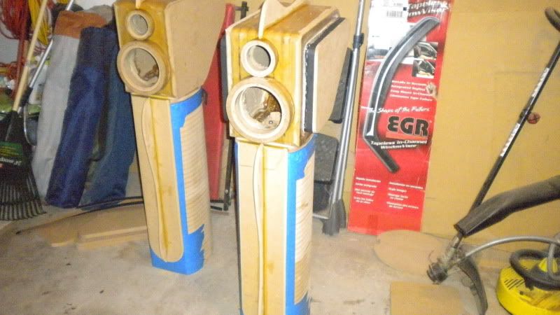

The side inlays are done... these are the last pieces of the puzzle before I start stretching fleece to fiberglass.. These will be veneered the same as the stands.. and puts the total side wall thickness to 2 1/2 inches..

« Reply #61 on: 30 Sep 2009, 03:48 am »
sorry for the crappy resolution... my camera sucks!!!

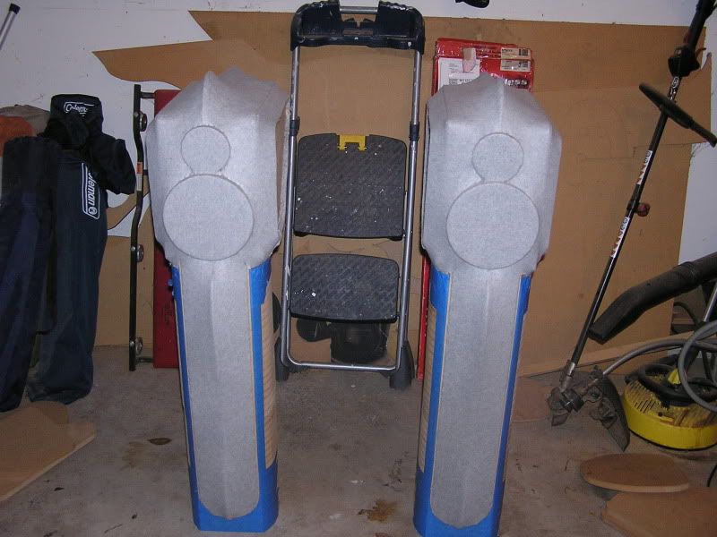

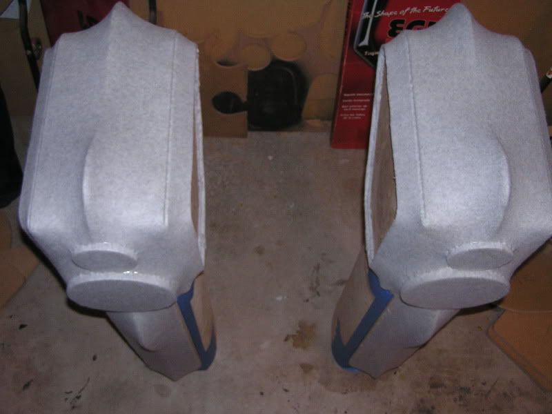

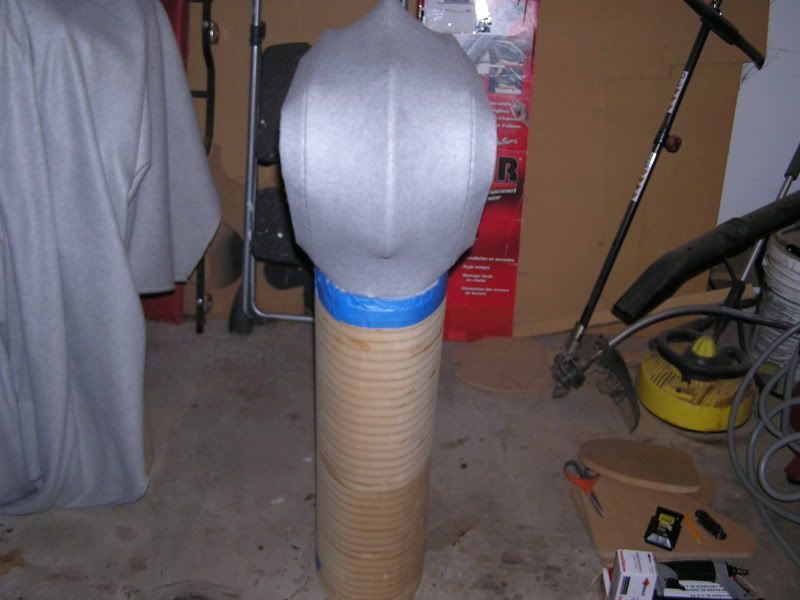

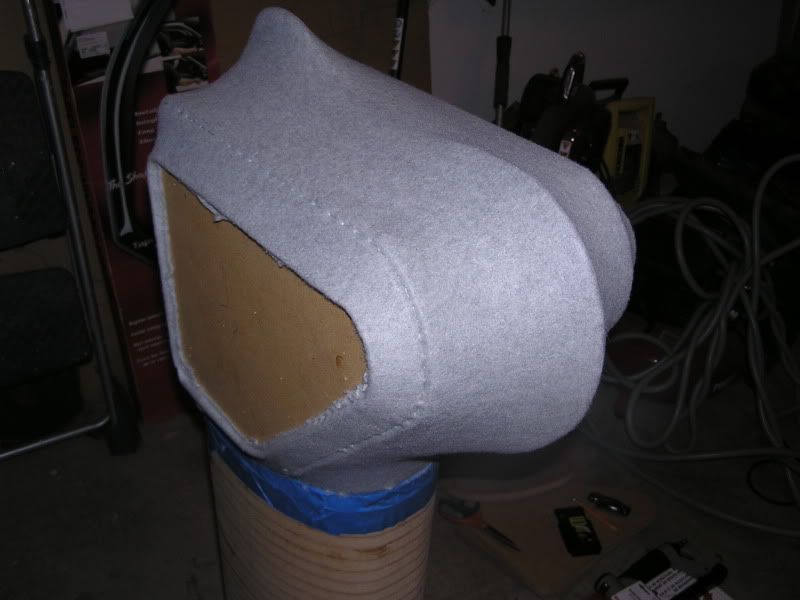

« Reply #62 on: 2 Oct 2009, 03:43 am »

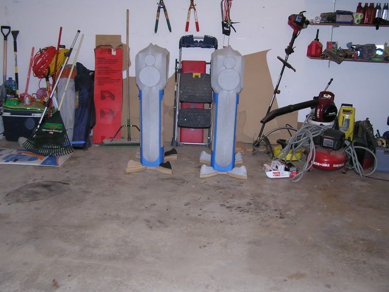

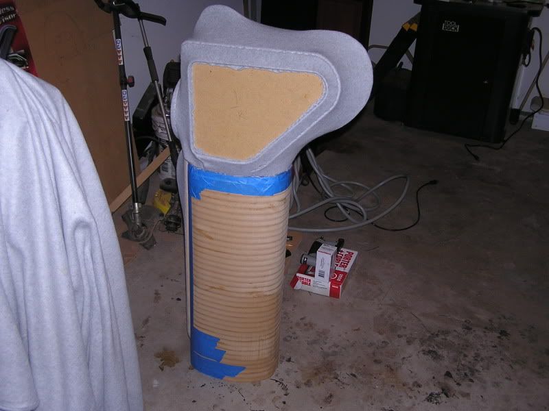

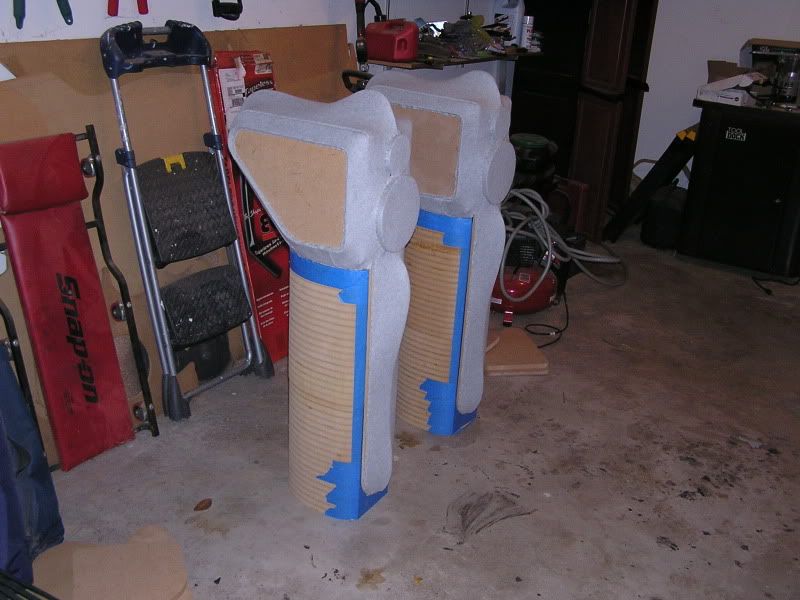

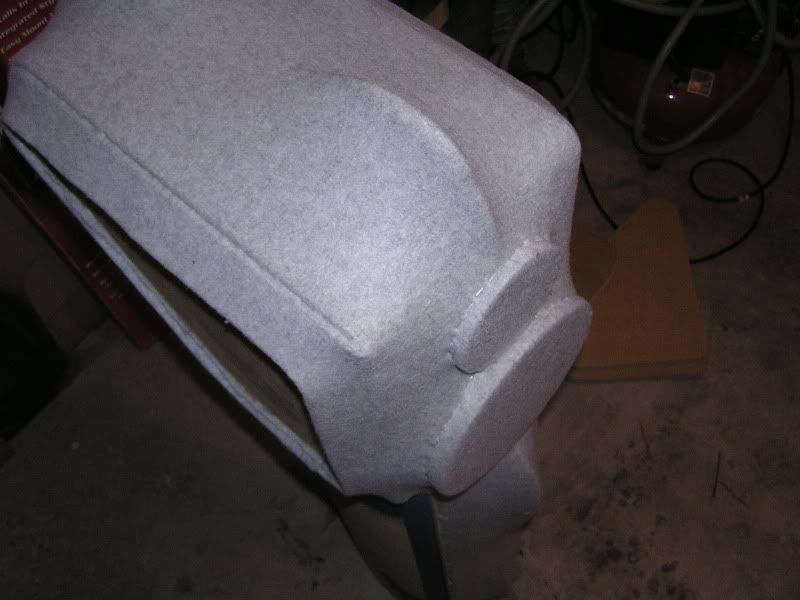

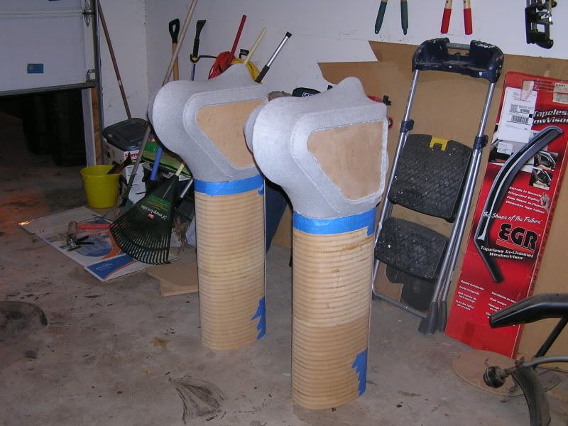

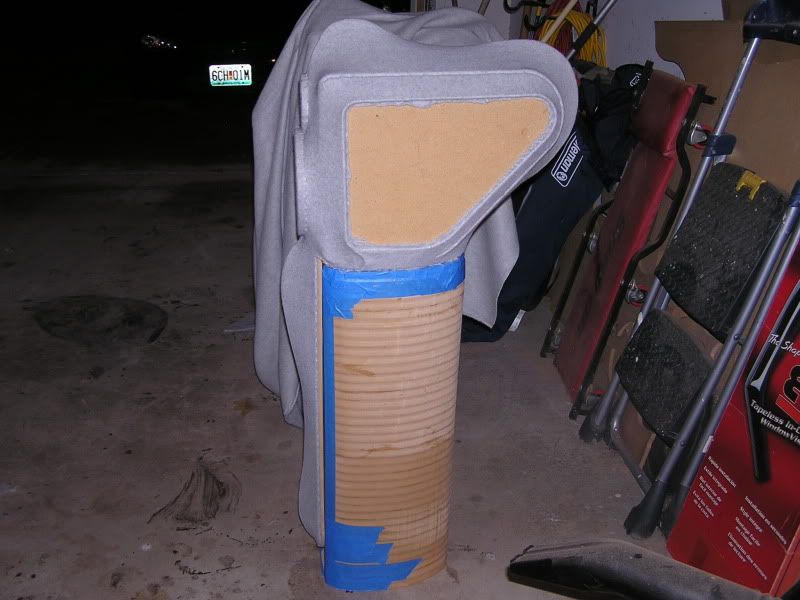

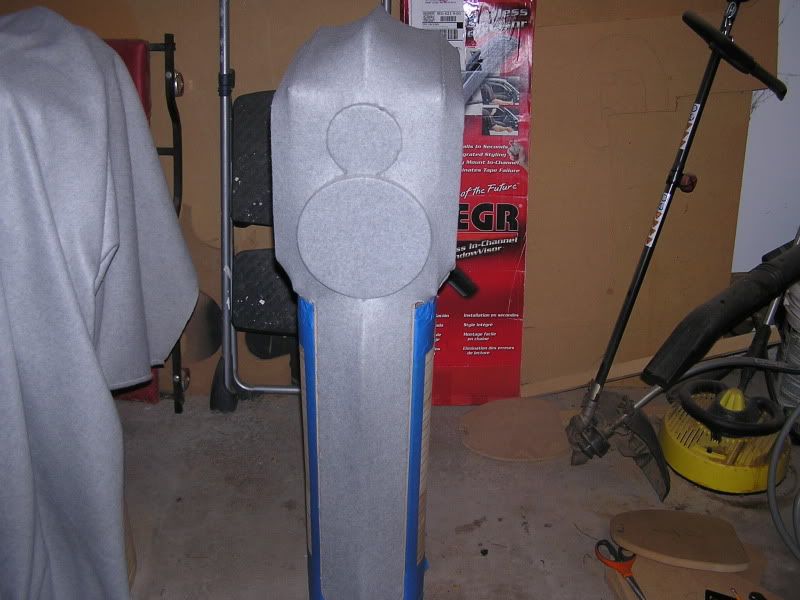

OK... I got fleece stretched on one of the speakers.. you can finally get an idea of the overall shape. After I get the other one tackled, I then will start to fiberglass. All that you see in gray fleece will be painted.. the sides will have a flushed veneered inlay and the stands/enclosures will be veneered to match..
HOPE YOU LIKE!!!!!!!
Bob in St. Louis
  • Posts: 13270
Re: Creations from my warped brain
« Reply #63 on: 2 Oct 2009, 04:02 am »
Very cool.
When you say you're going to "fiberglass" the next step, I assume you're going to apply resin only?
Also, do you fill the voids/cavities between the fleece and the MDF? Or do you just leave the cavities open?
Very cool Randy!  aa
Bob
« Reply #64 on: 2 Oct 2009, 04:07 am »
Hey Bob... Thank you!!!
The first step is resin only.. it takes allot of resin the first pass to make sure it's a 100 soaked through.. then a few layers of resin/matt..
there are voids now.. but that's why I overbuild the living sh*t out of it initially.. but it will be dense as I still have 1/4 of glass and duraglass to lay down before the fill primer

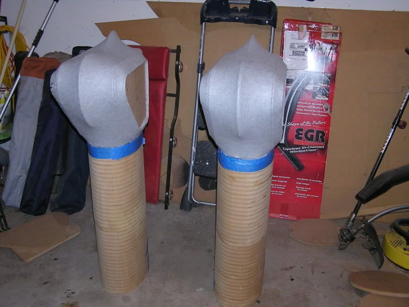

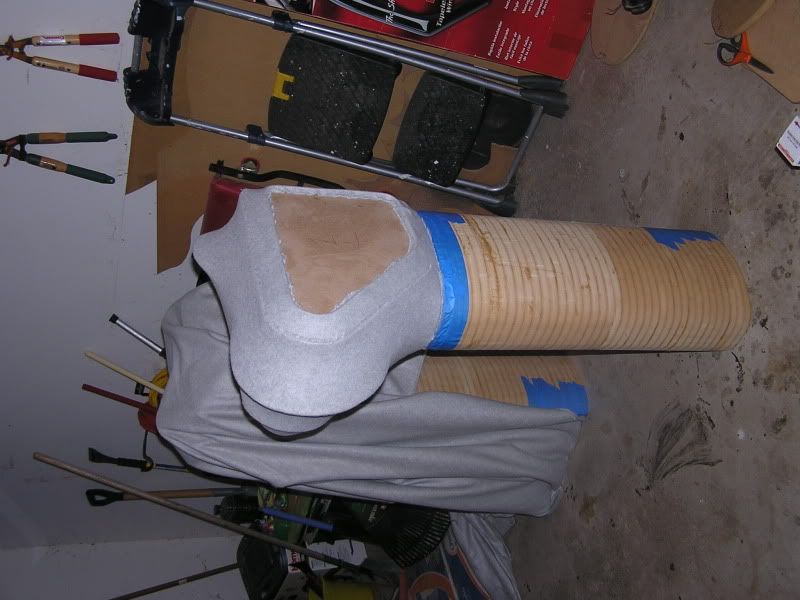

« Reply #65 on: 3 Oct 2009, 03:46 am »

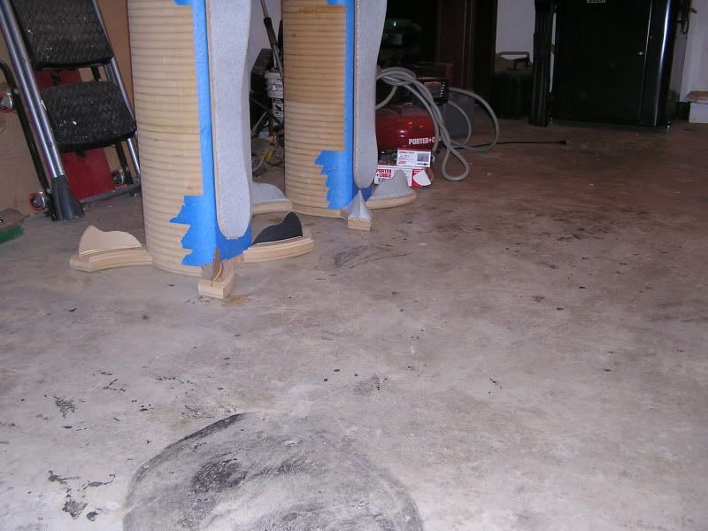

The second one is wrapped with fleece. Next is to make the bases for both... then off to Fiberglassing..
Hebrew Hammer
  • Posts: 546
  • www.Randall-K.com

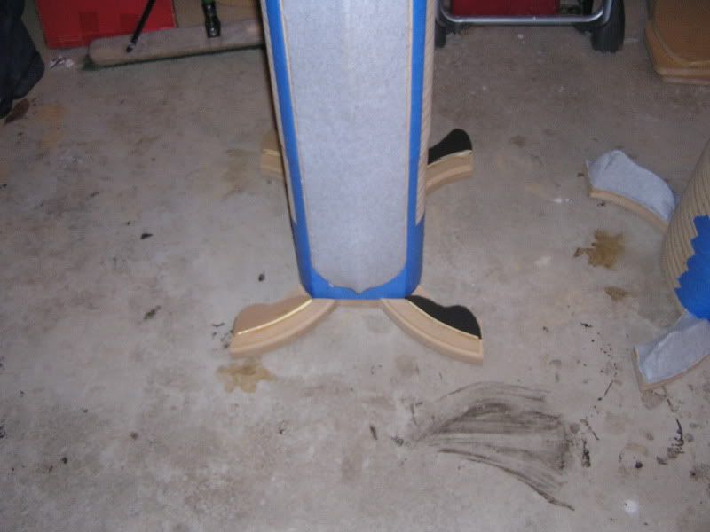

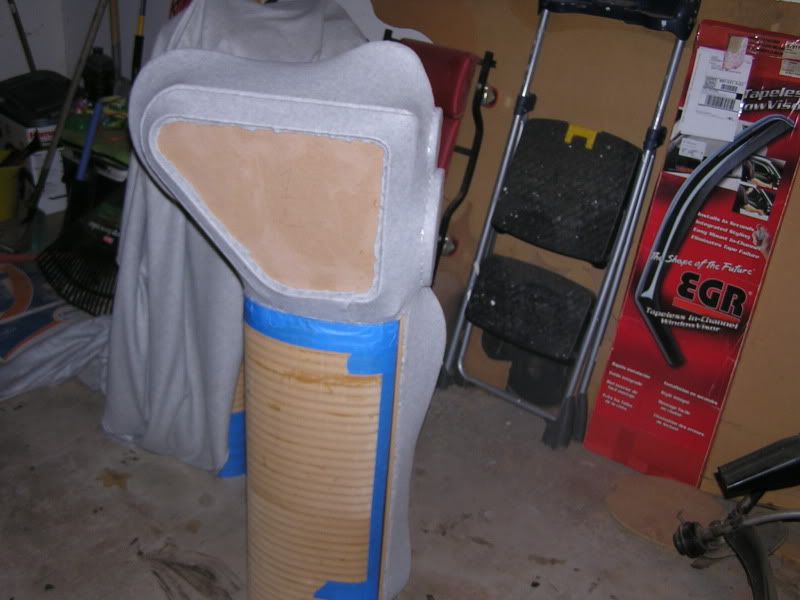

« Reply #66 on: 5 Oct 2009, 03:04 am »

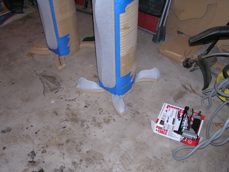

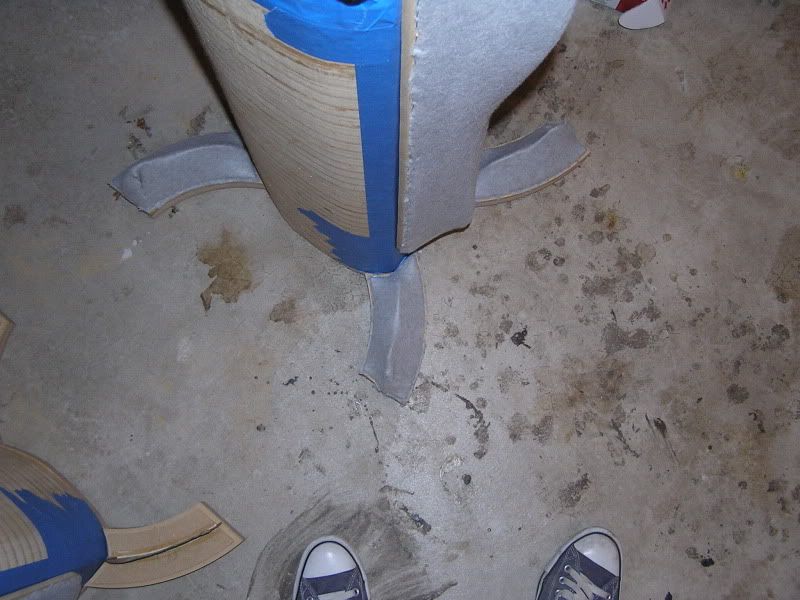

ok, worked on the stands today.. and I have fleece pulled on one of them. I will make the transistion from stand to base better once I smooth out the stand and veneer it before I bridge the gap between the two to create a tight fit...
