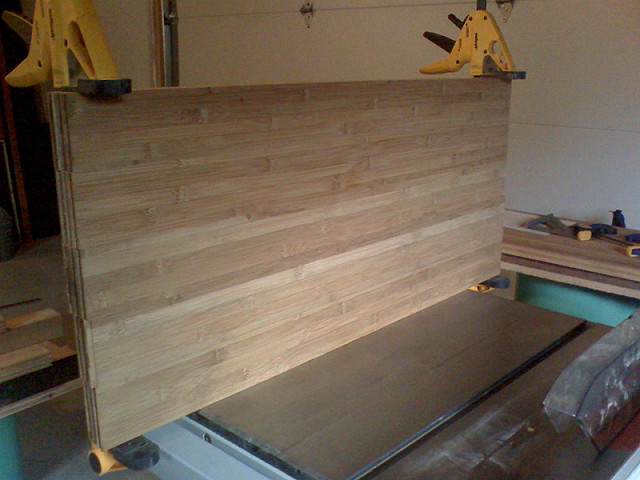

Believe it or not, theses baffles are not Ply-boo. They are bamboo flooring left over from my kitchen remodel :D I had two boxes left over and really liked the look so I planed them down to about 1/2" thick and glued them all together into a large plank.
For the production models I will offer bamboo ply because it took me a month to prep the wood and glue it all together. The only downfall of the Ply-boo is that it is hard to get in Northern Wisconsin and has to be shipped in which is pretty costly.
Here is a few pics of the bamboo prep.
