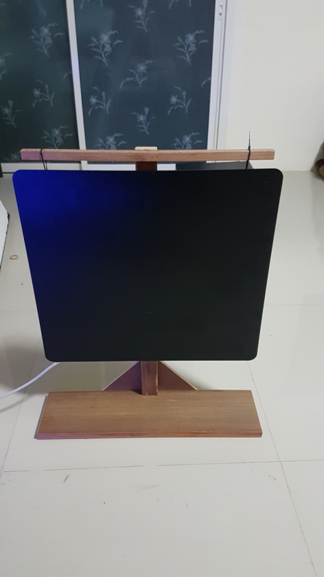

Not giving up on trying to necro this thread (yet).
So I made a stand and when I said think "dinner gong" I wasn't expecting it to sound like one (silly me) but it rang like a bell, the panel was ringing quite badly and lost a fair bit of bass response.
The weight of the panel resting on the polystyrene top (wall) and bottom (floor) was providing a lot of damping so the question now is how to provide effective damping and will it improve if applied to 2,3 or 4 sides?  The 2 x 40watt exciters are providing the drive the dense panel needs but at the same time that energy needs taming at the panel edges where I assume the ringing is produced without killing the highs.
I don't think any on-panel damping will make much difference so I'm going to try a simple wood frame with a U sphaped channel lined with sticky backed draft-excluder on the 3 internal faces to take care of the ringing.  Then the question would be how to stress the frame to try and bring back the bass response?  I see a MIG welder in my future... I'll try and update again but this next phase might take a bit of time.
Shame this stand didn't work out as I quite liked the look of it.  :cry: :cry:

@SteveTH That is very nice simple build there. Aluminium is vibration speakers best friend :) Combining with other materials gives smooth and solid frequency response. I think after 7 kHz is lowered more than your measurements because a phone... If you want best treble use a ribbon or an orthodynamic tweeter. Also try to combine with more exciters to get solid sound without unwanted big dips and don't forget to keep impedance over 4 ohm. Most amplifiers don't like lower than 4 ohm.

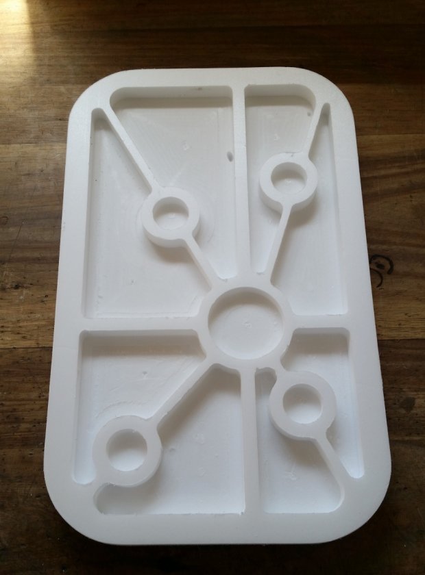

Hi all, first post but I've been stalking this thread for a while. I finally got my first test panel cut a few minutes ago. It's a small 250mmX404.5mm 25mm XPS panel, gonna start sanding now and apply the pva/water mixture and then start cutting another design.

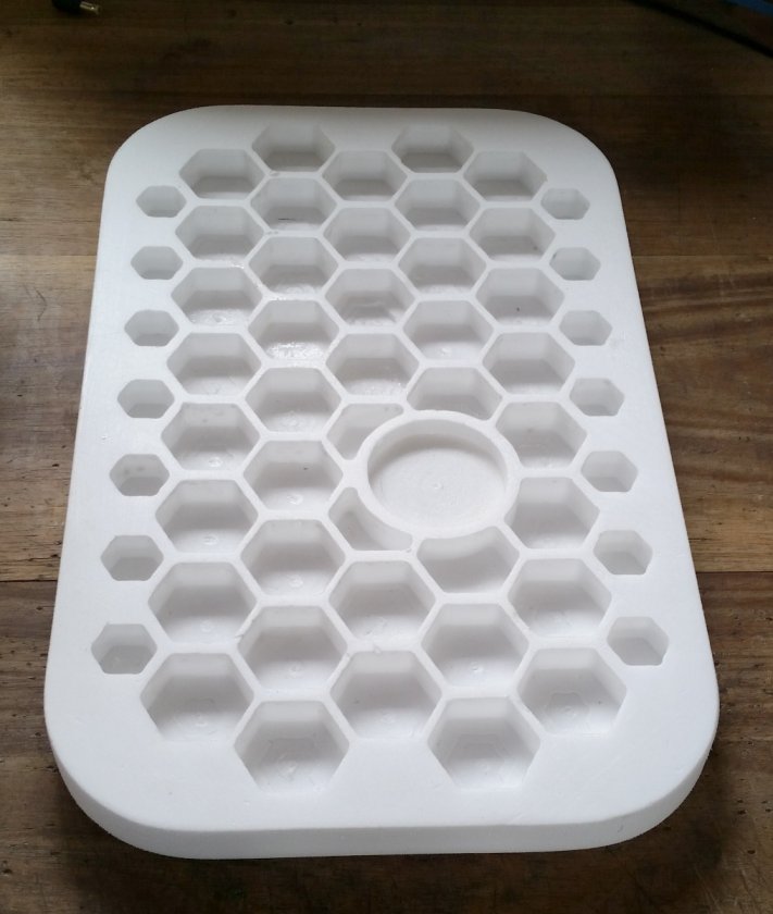

Second test panel
