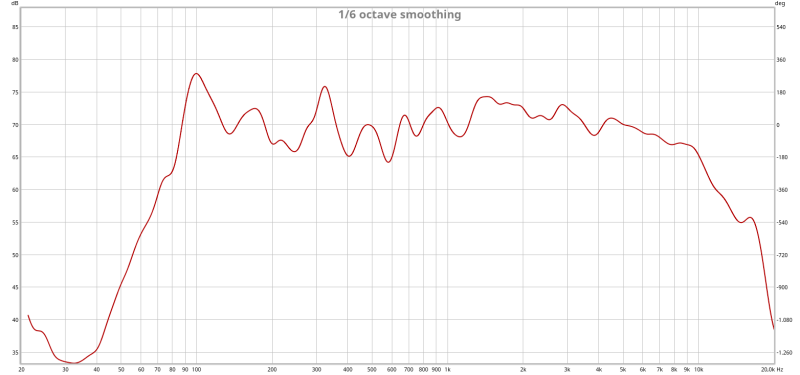

Let me give you a small update on my experiments. First I added a small exciter to my panel and take a frequency response for each:
Next I will order some components for a simple crossover at about 6 kHz.
Additionally I started the construction of an wall-mounted dml-speaker with a curved panel. As I read on another forum that someone made enclosures for dml-speakers out of foam board I thought I test some paper honeycomb board. I bought it for my dml experiments but it sounds not good enough.

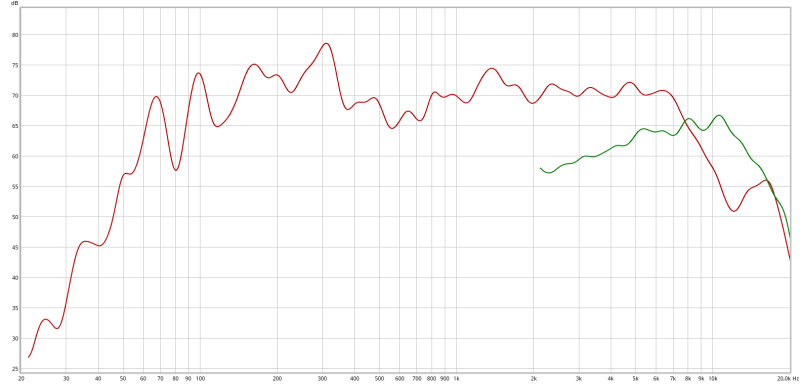

I have build a crossover for my panel. The highs are way better now. Relatively smooth up to 10 kHz, than falling rapidly.
I see this 10 kHz falloff on all my XPS 2cm panels. Seems to be material specific. The bended panel I am working on uses XPS with 5mm thickness. First tests by just holding an exciter against it suggest that they may play up to 20 kHz without falloff.
Like I've always assumed that a single exciter per panel is the best way to go for the most accurate of sound.....with that said my next project is to make a 2 way with two separate panels utilizing 1 exciter per panel instead of 2 exciters on one panel....
I second this. The panel I built sounds horrible when increasing the volume. The tweeter produces strong resonance distortions at ~470 Hz. Seems like the shaking of the panel is to much for it. I think I try to add a stick of wood diagonal at the corner to separate the tweeter part. Inspired by the bertagni speakers. ;)
I wish there was a way to let you all hear them I bet yawl be blown away and even more so when you realize it cost almost nothing to build them. LOL
That is the negative part of this hobby. You can capture an image of your speaker and show it to the world but you cannot let the world hear it. The only chance is to document your journey to encourage people to try it themselves.

One way to decrease tweeter resonance is to use a non polarized electrolytic capacitor (4uf) at around 5khz.
As mentioned I build a crossover. The takeover is at 6 kHz. But it is not an electrical but a mechanical problem. The movement of the panel introduced by the bigger exciter is to heavy for the tweeter. This is happening the same way when I disconnect the tweeter.
