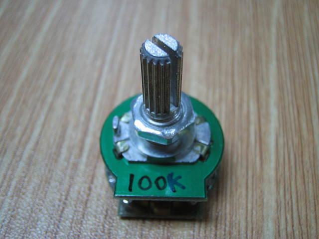

Welborne had posted a photo of an SMD stepped attenuator on the Virtue Two thread here:
http://www.audiocircle.com/index.php?topic=68893.0
So after searching around for that cool-looking gadget, I finally found it on eBay from a seller named tube_buyer in Hong Kong.
The photo above is the photo from tube_buyer's eBay ad. I actually bought the 50kohm pot as Michael Mardis advised me to start with 50k. This little attenuator has a smooth, solid feel. Since the attenuator didn't have lead pins, I soldered on small segments of Mundorf Silver-Gold wire to the small solder pads on each channel. The SMD resistors are actually mounted on two circular shaped PCB's (one for each channel) and mechanically fastened together. The hardest part was removing the stock volume pot from the small PCB containing the pot and pot bypass jumpers. Once I removed the stock pot, inserting the small Mundorf wire leads into the mounting holes was a piece of cake as it had an identical footprint as the stock volume pot's lead pins.
So how does it sound? Better, that's for sure. It's like wiping a dusty, cloudy window clear. There's just greater transparency and clarity in the sound. The soundstage is larger in all three dimensions. Part or most of this may be due to the fact that each channel is better balanced so the image is more life-like and centered. The sound is definitely fuller, and I expect it to sound better as everything burns in. It's almost like the stock pot cast a slightly dark tone on the sound. The amp sounds more lively like a tube amp. The overall improvement is quite noticeable. I also noticed that the noise floor significantly dropped too.
For having only 21-steps, the resistor values must be a great match for this amp, because the volume level steps are perfect. The increasing volume levels are nice and gradual with plenty of room to blow the doors off, yet spaced to allow nice lower level listening. I am quite pleased with this mod. Now I just need to re-work the volume knob to fit the shaft.

After listening for more than 100 hours after installing the 50k SMD stepped attenuator from eBay seller tube_man, I have to say that I am thoroughly impressed with this mod/tweak. The sound is warmer, richer and more detailed. The best way I can describe the sound quality is that it has greater weight than before with more harmonic content like a tube amp. I listened to Santana's "Caravanserai" last night and I could hear more interplay between Carlos Santana and Neil Schon on lead guitars on "Song of the Wind," since I was able to clearly distinguish the difference in tone between the two electric guitars. Percussion like the congas and Greg Rollie's Hammond organ just sounded incredible.
Before getting the attenuator, I was seriously considering a DIY tube preamp kit like a Glassware Audio Aikido or Transcendent Sound Grounded Grid, but I really like the simplicity of just having a better volume control in the Virtue Two. I don't have to be concerned with interconnect cables and another potential source of noise.

I bought 2 (cheap enough that I figured if one is good 2 is better for same shipping) of these from "gigaworks" also a hong kong based ebayer.
So what size wire was it that was used? I haven't opened up the virtue yet... need to take a trip to the shack or something...
-Tony

We liked this POT so much that we OEM'd it for the new models on the "x1" platform (it will remain a DIY option on the ONE.2).  For the lead-wire, it's so short and the current's so low, that it just doesn't matter what it is.  Strands of lamp-wire or cat5 or whatever, should work in order to bridge those tabs with the solder holes that line up quite well below it.  You'll need to drill out the plastic insert on the volume knob to accommodate the threaded version.  Our OEM ones (20k) use the flat shaft that fits natively.
panomaniac
Re: POT upgrades
« Reply #15 on: 14 Oct 2009, 07:08 pm »
These are very similar to what we will be using.  100K is not a great value for the Virtue, tho.  20K is ideal.
If I ever get the time, I'll do a little photo essay on how to wire them in.
