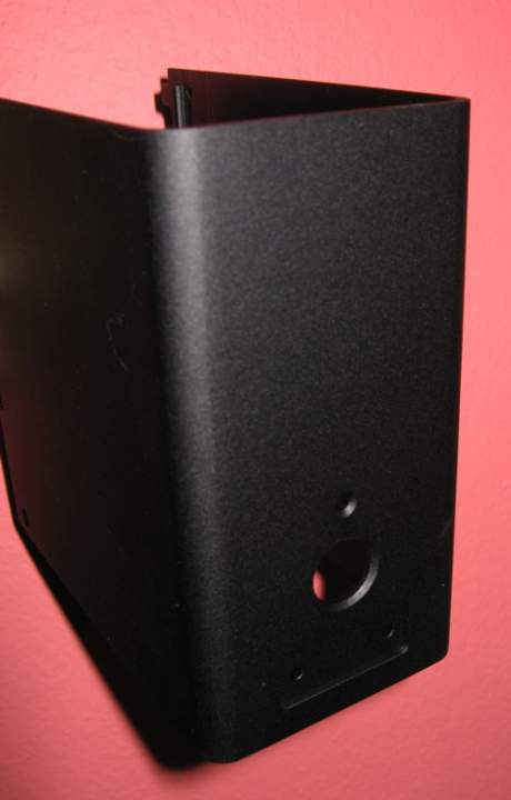

For those of you bypassing the POT entirely, here's a new accessory:
http://store.virtueaudio.com/ProductDetails.asp?ProductCode=VRTU%2DTPWA%2DNOPOT%2DBLACK%2D1
A wrap-around without hole for the volume pot.  It's priced a little higher than the normal one becausen we didn't make many of them.  It also comes in any color so long as it's black.

« Reply #28 on: 12 Feb 2010, 10:10 pm »
A wrap-around with hole for the volume pot.
Shouldn't that be 'without' old chap?  :wink:
