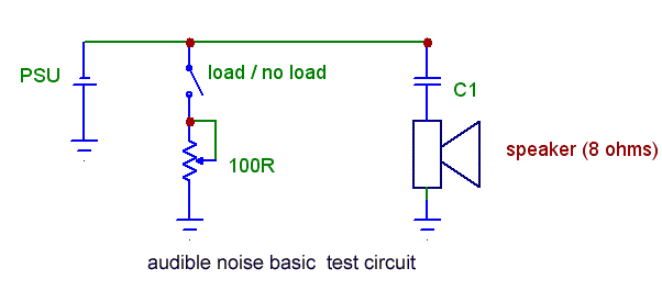

1) Under load there is a regular "pumping" of the noise.  I have not seen this in any other supply.  Tis also can be seen on an oscilloscope trace.
2) At idle (no load) the supply produces a high pitch whine in the speaker.  Similar to a siren, but at a constant pitch.  This changes briefly every time the supply cycles (~9 seconds).
3) Under load the supply produces a "chuffing" noise - like "chut-chut-chut".  If you know the sound of an impulse sprinkler, that is the sound.  This sound is the same at most load levels.

Just be a little careful with the circuit posted above.  The 100R variable resistor needs to be a high watt type or it will burn up. And you should probably charge up the cap before you connect the speaker, or you get a very loud thump!
But it does let you hear the noise of the PSU directly.  They are NOT all silent.  :nono:
