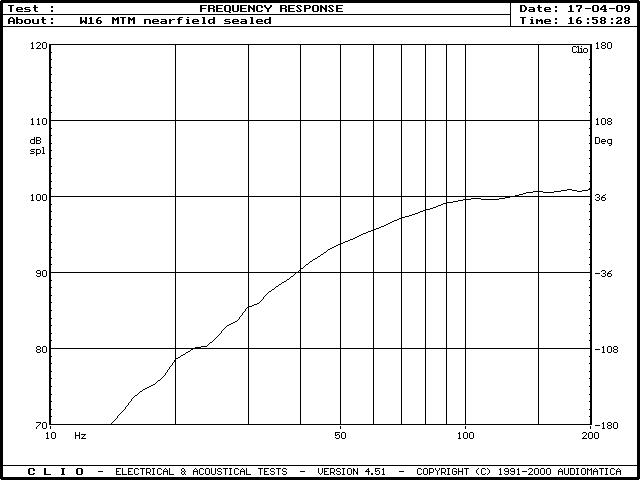

« Reply #10 on: 20 Apr 2009, 01:51 pm »
Rick:  The Prestigio looks really nice and verrry tempting.  I'm looking forward to reviewing the nearfield measurements.  If I plan to use these with a subwoofer would you recommend the sealed version?  Are you planning to offer these in kit form and if so, what would be the cost?  Also, not so long ago you introduced the Garnet MTM.  I know it is subjective, but how would you compare the Garnet and Prestigio?  Is it as simple as whether someone prefers a ribbon or dome tweeter?  And how would you describe the difference between the Prestigio's metal mid-range drivers and the ceramic ones in the Garnet?  Thanks!
Here's the sealed box response curve...
This is -3db @75hz and -10db @41hz. Perfect for crossing to a subwoofer at 80hz. If you need a lower crossover point (50-60hz) you can go ported (nearfield measurements coming later). The ported version is a good option for combination music/HT systems where the owner prefers to run some (or all) music without a subwoofer. Most of our subwoofer customers tend to run sealed monitors because are subs work great with both music and HT.
