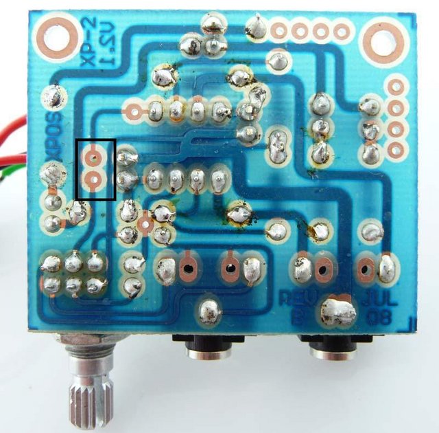

I sat down and put my cmoy together really pretty straight forward build except for the one jumper they forgot to mention. I only had one channel when i first tried it. Checked my solder joints. for cold bad joints but everythinkg looked good started to trace outthe circuts and found a place that should have had a jumper. This thing will drive my BEYER DYNAMIC DT770-Pro 250ohm Closed Circumaural Studio Headphones to an insane level Bass is Good right?

Hello, i bought the same kit and had the same problem (sound in the left channel only), could you tell me where is the missing strap ?
A picture would be perfect (i'm not good in electronic, i'm not good enough in english  :?)
Thank you

Coming off the center tap of the volume follow the trace up and you will find a gap outloned in picture try placing a jumper there and you should be good to go

Thank you for your quick and detailed answer, i did it but it still not working  :cry:
Sounds comes only in left ear.

Really not a lot to go bad with this
1. Get a flashlight and check your solder joints make sure they are all shiny not dull or wrinkled looking if so retouch them .
2. try wriggling the components see if one has a bad solder joint

I'm afraid it's a lost cause now, i tried wriggling, nothing, i check the solder, nothing, and now, i blew the pcb with soldering/desoldering components.
It was my first DIY project (in audio), it won't be the last even if this one was a failure.
Thank you for your time

Even if you lifted a trace, you should be able to use a wire and go point to point where the broken trace/solder pad is.

Any chance you can get a picture of what you did to the board?
