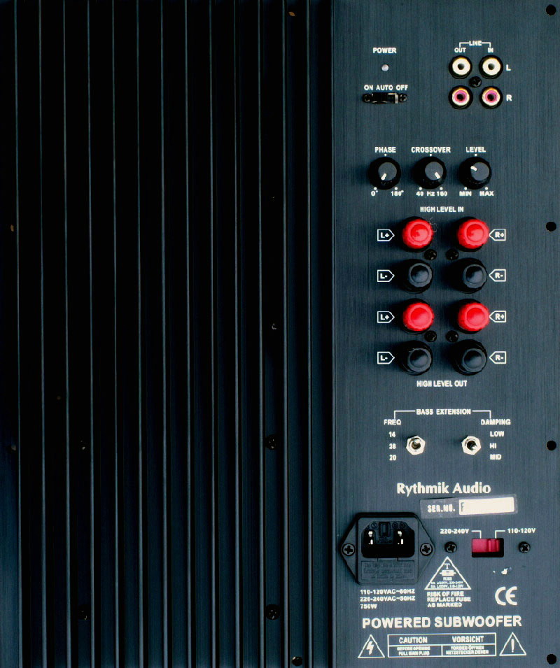

Another forum member's old build, but droooooooool  :drool:  50hz seems a bit high; the servo in the picture is crossed at 28hz.
A little late in the game, but just wanted to correct the OP's above observation about the crossover settings of the servo sub: the subwoofer in the above picture is not LOW-passed at 28 Hz., it is set to have the servo correct DOWN to 28 Hz. The lowest LP setting is 40 Hz. on that sub - I know because I have one.
To digress a bit more: I'm not sure why exactly it is set to correct down to 28 - that's the highest (ie: worst) option (http://www.rythmikaudio.com/images/A300SE.jpg), it can also do 20, and 14. The latter (14 Hz.) is the best choice for sound quality - it has the best group delay curve, which is what you want for reproduction, especially in a system as nice as that.
I've said it before: the Rythmik subs are the nicest I've ever heard, and are utterly unobtrusive during use, but offer SO much ambience and detail retrieval: I was amazed at how EVERYTHING sounded better after including it in my system - even girl-and-guitar type music with seemingly no LF content. Everything was better.
An active crossover overcomes that 40hz limit  :green:

« Reply #66 on: 6 Oct 2010, 02:08 am »
