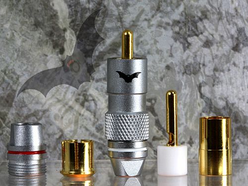

Low.phile,
The HK receiver I'm familiar with is the 3480. The consensus, FWIW, based on net chatter, is that the 3490 is an all around better component. I've not heard the 3490 myself.
My jumpers are built each with a 3" length of dead soft annealed .070" diameter pure silver available from myrontoback.com
http://www.myrontoback.com/47.html
a bit less than 13ga
soldered at each end to the center pin of a Tiffany style rca plug, which is a gold plated center pin mounted in a teflon cylindrical 'donut', as shown below -
I've used the PartsExpress versions -
http://www.parts-express.com/pe/showdetl.cfm?Partnumber=091-400
The Tiffany style center plug provides those donuts to grip for removal and insertion and the thick silver wire provides bulk and solidity if one isn't so gentle.
Those steel links IMO are a malicious piece of passive agressive manufacturing.  :x
FWIW,
Paul

« Reply #14 on: 15 Feb 2009, 06:59 pm »
It applies to any receiver/integrated amp that has jumpers/links connecting a 'pre-out' to a 'power-in'. NAD,HK, Brystron, etc... Ya gots to look on the back of your component.
Get 4 of these doobers from 2 pairs of Tiffany style rca plugs (discussed above)-
1. Take 2 4" pieces of wire, your choice. If insulated, strip enough insulation on each each end so that the bare wire fits into the donut far enough to be seen through the little 'scallop' (the scooped out part right above the white base) at the base the cylindrical plug.
2. Solder the wire in that 'scallop', making sure none of the solder goes on the outside of the plug which might inhibit full insertion.
3. Carefully bend the two newly terminated jumpers to fit where the previous jumpers were.
4. Insert.
5. Sit and ponder how whatever effect takes place, if psychological or objectively measureable. Repeat as necessary.
FWIW,
Paul

Paul,
Do you not bother connecting the shield/ground wire?
Also, while I like to DIY, for $25 + free shipping the AudioQuest jumpers on amazon seem like a nice quick solution.
-West

West,
At that price, I'd go with the Audioquest. I actually have an older version of those jumpers on my NAD in the TV system. I've compared them to my own recipe, and really couldn't tell the difference.
The ground isn't necessary in the links because the pre-amp and poweramp sections already share a common ground. If you don't mind going inside and invalidating whatever warranty, its easiest to solder a wire for each channel internally connecting the pre to the power amp, and skip the surperfluous connections.
-Paul
