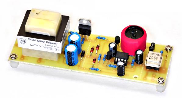

My DEQX will in Januari go back to AU to have a very important mod ( which was partly in the design of the DEQX III,  but at the last moment canceled) the replacement of the crystal for a much better ( Guido Tent clock) I take the plunge to choose a super stable pws +clock from Joe Rasmussen
The TERRA FIRMA Clock
http://www.customanalogue.com/terra_firma.htm
