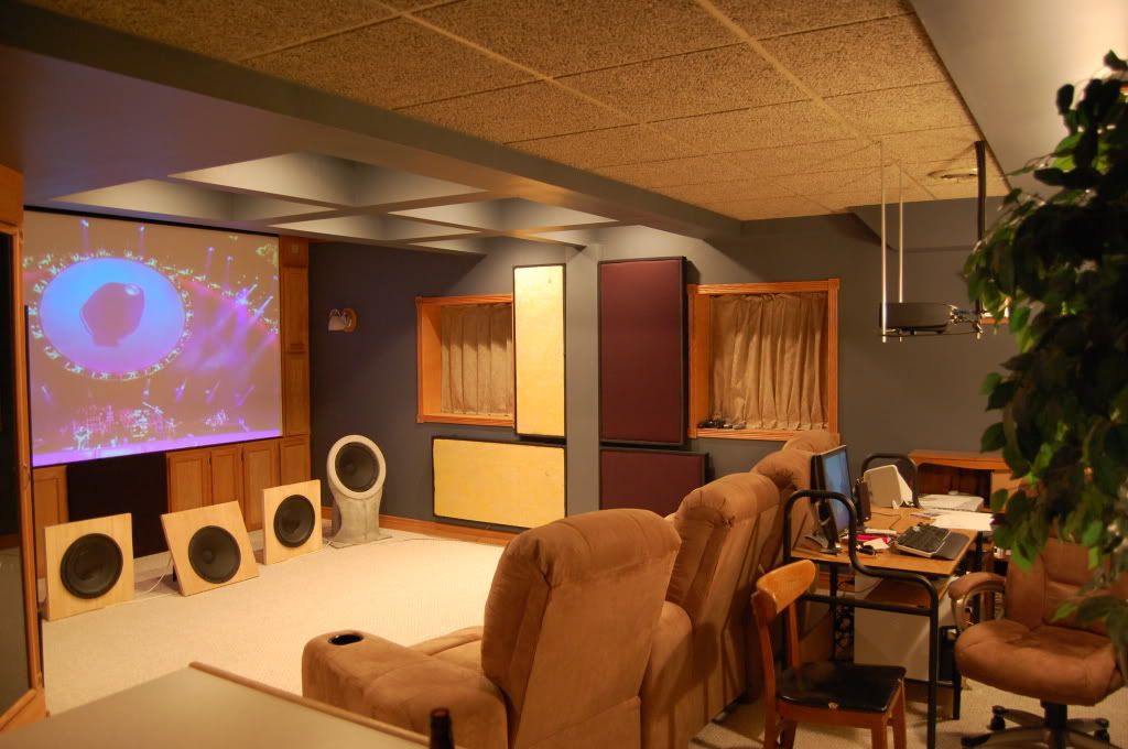

Finished for the weekend.
All of the panels are built and installed. Most of the panels need fabric as you can see.
{Please ignore the brown color of the panels. Some kinda photography thing I haven't figured out yet, but the panels are actually black.}

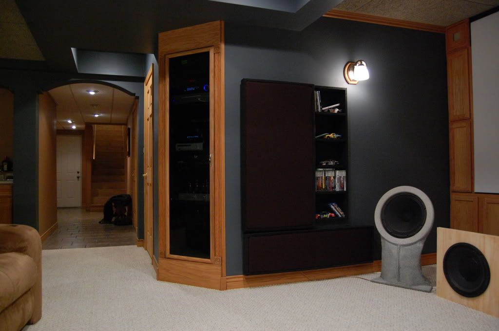

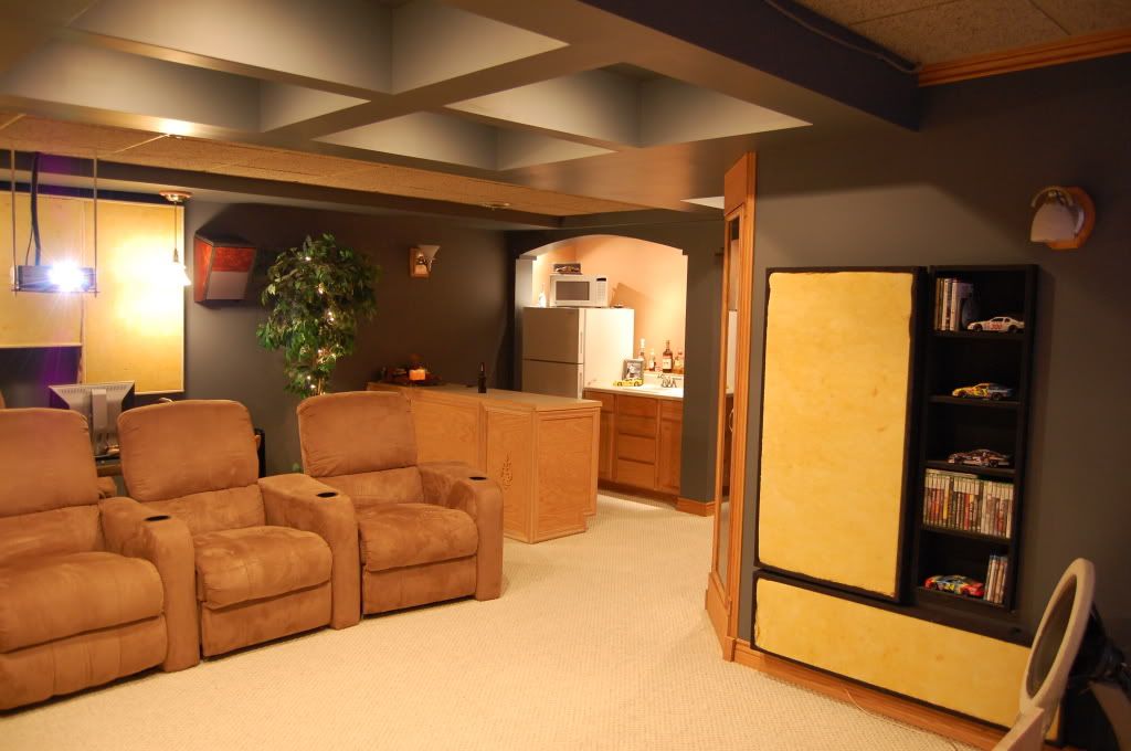

The view from behind the bar, the four panels for the first reflection point on the right wall:

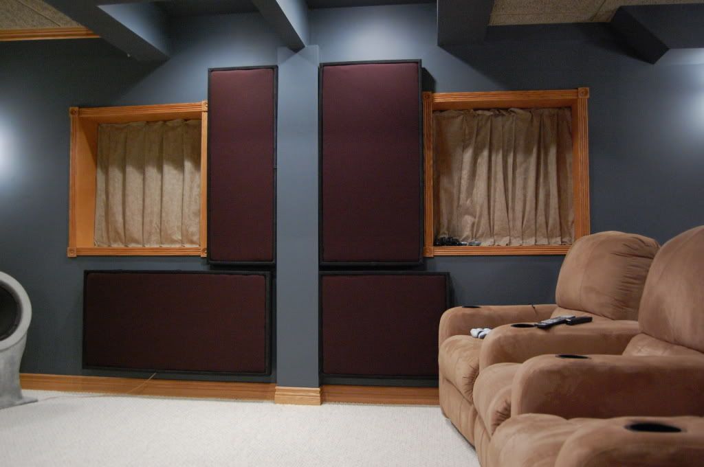

The view from behind the right main channel speaker, two panels for the left first reflection point:
Alright acoustic guys...How am I doing? Am I on the right track?  :rock:
There's a few places that Bryan told me need to be treated as far as dedicated bass traps are concerned, but I need more 703....another day. Any more suggestions? Ideas?
Everything look good so far?
Diffusion somewhere??
Bob

Robin - Thanks man, but the wife HATES it.  H.A.T.E = HATE:(
The two on the right wall that flank the pillar are too wide in her opinion. Admittedly, when I measured my desired width I forgot to subtract the thickness of the wood so they are in fact a bit too wide. The fact they overlap the wood work around the windows is what bothers her most.
I may take those two down and fix that. Maybe.

Now that I look I can see she's kind of right about the width over the window frames, bummer. Hopefully you'll find an easy way to trim the panels.

Dude, I can't recommend treating your room enough. The difference it make is more profound than any single piece of equipment I've ever installed. Hanging stuff on the walls certainly doesn't have as much "cool factor" as something that plugs in, but MAN......Do it, Do it, Do it. Huge difference.
Yea, I'm not excited at all about taking these from the wall, taking them apart, hacking a couple inches from it's width and reassembling.  :duh:
But the more I look at them the more it bothers me. The fact they're squeezed in there gets under my skin. The wife said, "It looks like I just bought some shit and stuck it where it could be shoved in".  :|
So, it'll make both us happier if I just "man-up, and get-r-done".

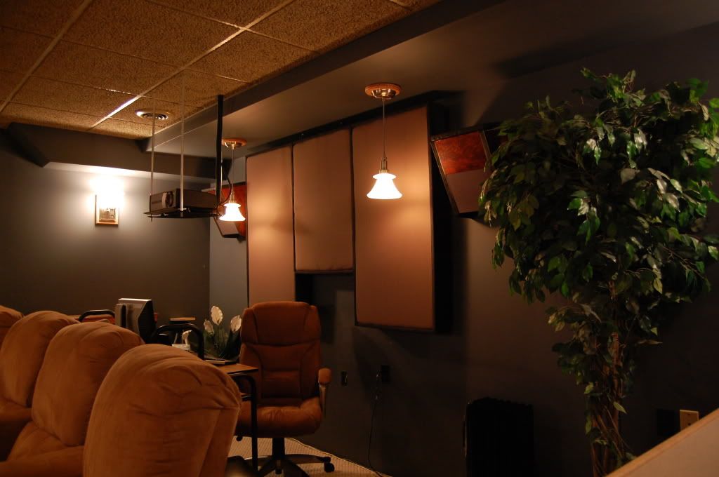

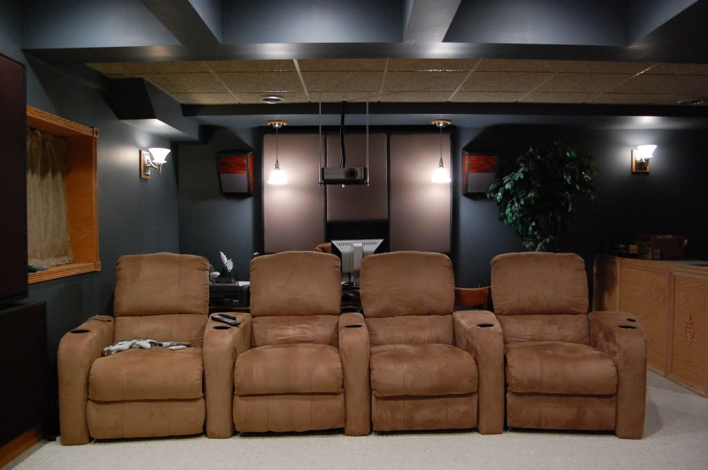

Finished with "phase I" of panels.
Bass traps are another day.
Things are sounding very nice.
(still playing with camera settings for more color accuracy)

Looks brilliant Bob.  :thumb:  You should charge for admission.  :icon_lol:

Very nice work Bob.  Looks like a well treated HT space.

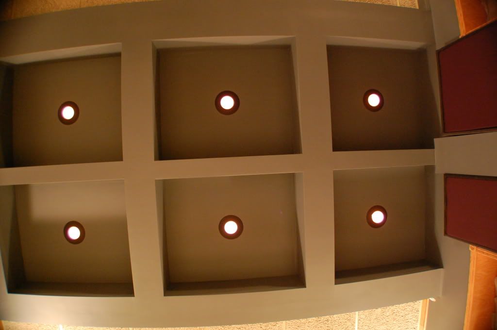

Bob, I was wondering if you could comment on the ceiling insets in the front of your HT.  Was this by design, or coincidence?  I would imagine that they provide some diffusion in your front soundstage, and they look very cool as an architectural accent.   :thumb:
Bob in St. Louis
  • Posts: 13270
Re: Which is first: Test, Measure, Purchase, or Guess?
« Reply #76 on: 10 Dec 2008, 12:39 pm »
Hey there, Thanks for the inquiry.
I did the inset out of necessity since there are three beams that run down the length of the house. My #1 goal was to have as much ceiling height as I could get, or at least give the illusion I had more height than I really do. So, I boxed in the beams and drywalled around them. But before I installed the drywall, I stuffed as much rolled R-19 in there as I could. When I built the room, I knew very little about acoustics (still don't), but I knew that irregular shapes where good (diffusion), and I knew voids, or open cavities behind drywall was most likely a bad thing.
Each inset is 31"X40" and 11" tall and each one has a recessed light fixture. The fixture actually is so high up inside the ceiling, they're sitting between the floor joists above. From the carpet to the bottom of the insets is 7'2", and to the suspended tiles is 8'2".
The only drywall I have on the ceiling in the basement is this 90" wide "set of squares", the rest is all suspended tiles.
The area directly in front of the screen, and directly over the listening position are all 2'X2' "USG Glacier 707.107 Taupe "Shadowline" tiles.
Here's a photo. I set the camera on the floor pointing straight up. As a frame of reference, you can see the tops of the acoustic panels on the right wall.
