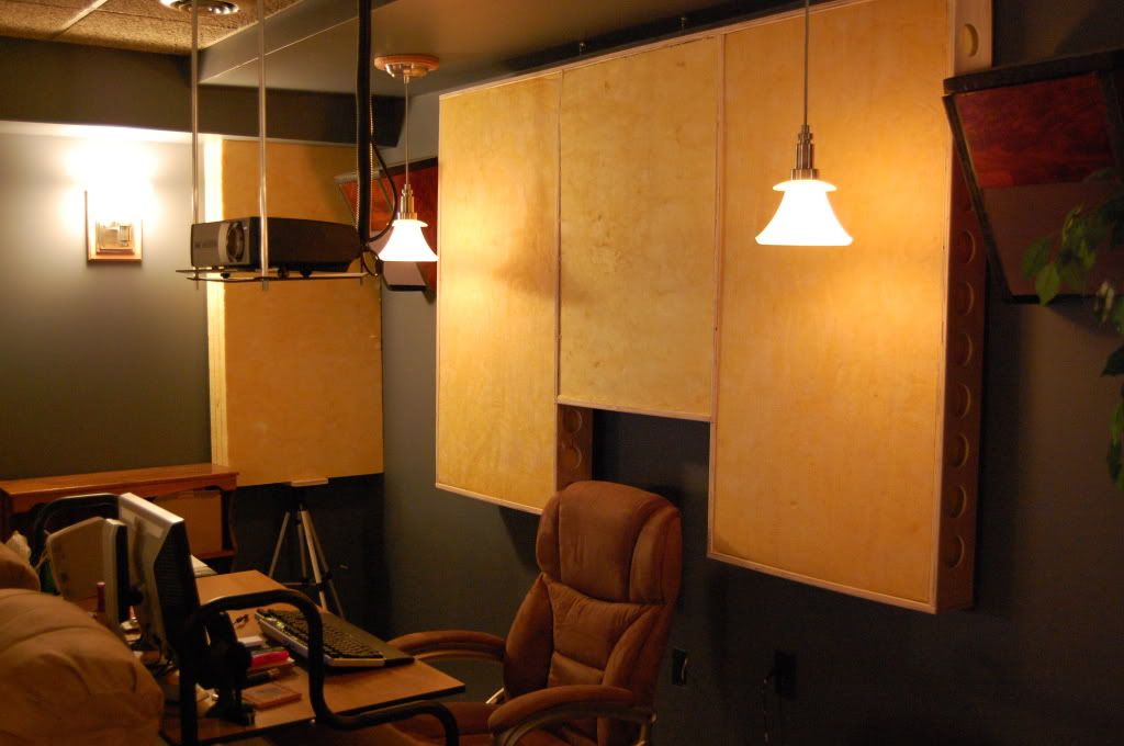

I thought they looked quite "finished" when I saw them.  I actually thought they were covered in fabric at first.  If this image is in fact closer to what the color actually is then I really like the combination of the forest green walls and the yellow fiberglass texture.  If you had wood frames to match the wood trim of the windows and just the bare panels, I dunno, call me crazy but that would look really good.  I suppose you want some kind of covering to contain the fibers, though.  Hmmm.
While I agree purely from a 'color' standpoint, the last thing you want in a home theater space is lighter colors - especially there where lighting from the back would reflect off of them and wash out the screen.  I'd vote for a darker color.

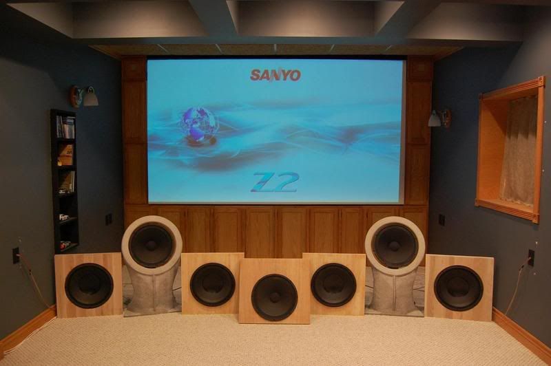

No Nathan, there's no green in there at all. The walls are a medium/dark(ish) flat gray. The yellow panels are the bare Owens raw material color, which by the way, isn't as attractive in person as the photo. I'll be covering the material mainly for cosmetic reasons, but having uncovered insulation covering the walls isn't good with children. With exposed material, I'd have little finger holes poked in all the panels.  :roll:
As I mentioned earlier, the photo was taken without much regard for color accuracy. With dimmable lighting, it takes a while to get an accurate reprosentation of the walls. With the cameras flash on, they're a bright weird blue for some reason. Having both of my camera tripods holding up the rear panels, I wasn't going to dilly dally around with photography. I just wanted photos of the panels.
These are the most accurate wall color photos I have (depending on ambient lighting levels:
Doug - Thanks for the link on the burlap. I've thought about the burlap but hadn't spent any time sourcing it. Being lazy, I was just going to go with the standard black speaker grill fabric. I'll check that out, thank you very much.   :thumb:

Today's accomplishments........

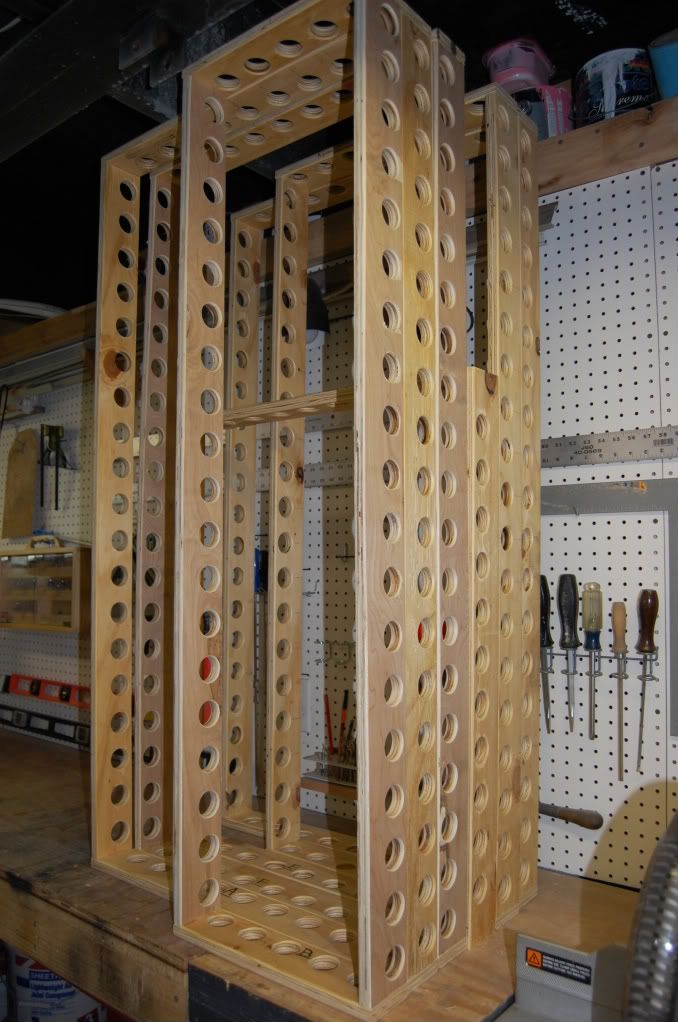

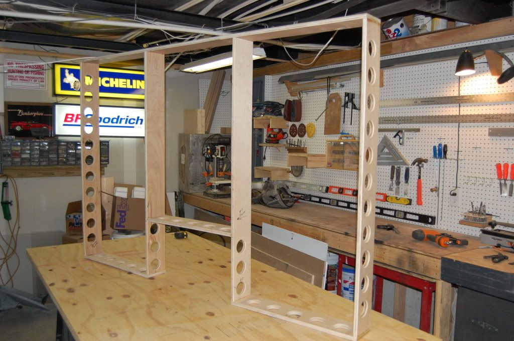

The 4" thick panels are in 5" thick frames (with holes), hanging 2" from the rear wall.
The pretty covering comes later. The bass trap in the corner on the camera tripod is temporary.

Bob in St. Louis
  • Posts: 13270
Re: Which is first: Test, Measure, Purchase, or Guess?
« Reply #46 on: 24 Nov 2008, 03:51 pm »
:lol:  Yes I did. And that's not just 43 holes, that's 43 holes that have a 1/4" roundover ....on both sides.
So I got my monies worth out of the router too. aa
Thanks for the complement VA!

My arm got tired just looking at all those holes! :lol:  Is there a reason why they aren't centered, though?

The drill press and 2 1/4" hole saw came in handy. The arm wasn't too worn out. Doing it without a drill press would have sucked BIG time.
Eventually, I'll paint the frames and wrap the panels individually as opposed to wrapping the entire unit. I think it will have more visual appeal this way. To date, I've not done anything the easy way. I figure if it's a big pain in the butt, then the end result will look better than if I take the easy way out and make it look cheap and cheesy.
When the panels get wrapped, the back side (against the wall) will undoubtedly look like crap. I wanted the frame to extend further back than the panels to help hide the ugly back side. The panels are 4" thick, the frame is 5" thick, the entire unit will sit one or two inches from the wall creating an open air cavity that's two of three inches in depth. With the possibility someone could see behind it I made frame extending beyond the panels.
At least this seemed to be the best way to do it?  :dunno:
It took a Helluva lot longer to build this than I originally thought it would, so this is the only one I've gotten assembled.
The design of others will match this one, just smaller.
Bob
EDIT: By the way Nathan, the above photo is a realistic color for the walls.

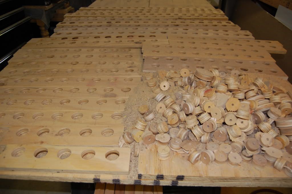

384 holes, including the panel I made last weekend.  :o
Off to the router table to smooth the holes...........

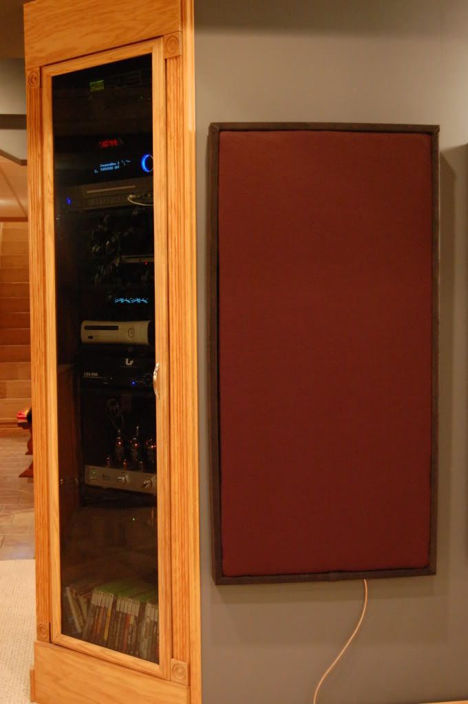

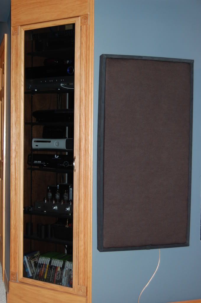

It's the same photo, but one doesn't use flash on the camera, which makes the black speaker grill material look brown  :scratch:) and the other uses flash, which is a realistic color depiction of the panel, but a VERY unrealistic wall color.  :dunno:
I may need to ask the Eye-Fidelity folks what's going on.
Oh well.
Alright, here we go:
Notice the two different colors; One for the frame, the other for the panel:
{NOTE: Please ignore the left side of the frame is bowing out, I'll fix that later.}  :roll:
^ Wrong wall color, correct panel color.
^ Correct wall color, incorrect panel color.
