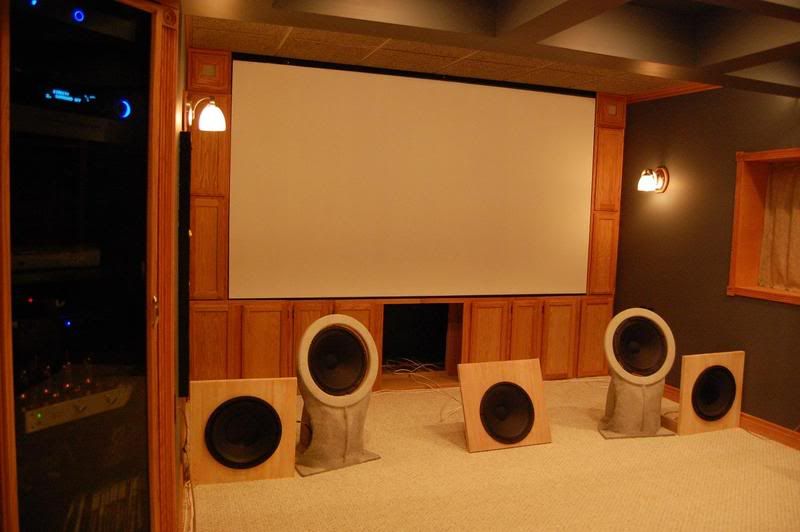

So I find myself with an overwhelming desire to treat my Home Theater/Two Channel room. Conveniently, I'm also in possesion of small sum of cash. Enough for three boxes of "703". I was "this" close to placing the order this morning and had a thought: "What am I doing"?  More specifically, "What exactly is my goal"?
So I realise it's not brain surgery to wrap some 703 with a visually acceptable material and hang it on walls in the proper locations (it takes about 5 minutes of research online to learn the definition of 'proper location' after all). But....What am I trying to accomplish? Of course I'm treating my room, but treating it for what? Do I have a problem from 60Hz to 90Hz? Or is it from 2,487.4Hz to 2,754.1Hz? Or room modes, decay, nulls, or....
I know that ALL rooms need a certain amount of treatment, just the nature of the beast. But if I get a few boxes of 703 and sprinkle the panels around my room, do I THEN take measurements or do I leave my room in it's current (untreated) state and measure first to pinpoint exact problem areas. What if I buy a bunch of 703, line my walls only to find out I should have bought 705 instead? (that would make Bob a very unhappy boy). What if, a problem area I have is made worse by me blindly Spackling my walls with fiberglass? THEN I do measurements only to find out I need to throw away half of what I bought.
I see thread after thread, article after article talking about the virtues of treatments, but nowhere does anybody talk about how they came to the conclusion to do what they did. They just hang stuff on their walls and talk about how great it is. Couldn't possibly be that easy.....could it?
Direct Questions:
#1 What are the proper steps in sequence to properly treating a room.
#2 When measuring a rooms response and looking at your graph, how do you know that the results are a "picture" of your room, or a "picture" of what your speakers are creating. (One repaired with treatments, the other with EQ / crossovers etc..). Or am I supposed to drag my speakers into the middle of a football field and measure them to see what they're doing separate from the room?
#3 Or, will I get "95%" of the way there by using a couple boxes of 703 and build some bass traps, and we'll call the rest "the proverbial point of diminishing returns".
#3 I'll have more questions, but am not intelligent enough in the subject to know what they are yet.
Thanks guys,
Bob

Most rectangular rooms ......will benefit from ......absorption behind speakers
The entire front wall is my "rebound area" for open baffle............in case that matters.  :scratch:
Not much info regarding open baffle and treating a room. I would assume there's a difference???/
Nathan, I like the podunk method. I'm good at that.  8)
I've posted enough pictures of my room on (too many) threads so I'll spare you guys unless you think it will help, but as Nathan said, I'll most likely run out of space before I "have enough". My walls are pretty full without having panels on them.
Thanks guys,
Bob

Young-Ho - Interesting... There's some good points in there. The cost of a couple panels in the null area of an Open Baffle zone doesn't bother me too much. These panels are fairly inexpensive when purchased by the case and one on each side shouldn't break the bank. My biggest fear is screwing something up after treating the entire room and then having to diagnose which panel(s) doesn't belong.
Regarding the front wall, the screen is cloth covered wood (torsion panel construction) and of course reflective. Not much I can do about that at this point without major renovation. You see, the screen (5.5' tall X 10' wide) is hinged and there's storage shelves in there. In addition, this is where the Infinite Baffle (IB) drivers live. The point is that I can't make the screen out of something that will allow the IB rear wave to come into the room. So diffusion is (almost) out of the question. The one pretty neat thing I can do; My screen is surrounded by cabinetry. In critical listening situations I can open all the cabinet doors which naturally provides a certain amount of diffusion when all of the doors are opened 90 degrees. I've had daydreams of filling the cabinets with treatments, either DIY diffusion "inserts" or absorption "inserts". This way I could open just the right amount of doors as needed.
What do you think of that?  aa
Ethan - Ok, I think you've clenched it as far as I'm concerned. Your "imitating the common denominator" suggestion confirmed my suspicions. Obviously there's a reason well treated rooms are well treated, if you know what I mean.
It would be fun and a good learning experience to measure before, during and after treating just to see what happens along the way (I read your article about EQing versus MondoTraps with great interest) however, my goal here is to get 90+% of the way there and sweat the details some other day. Too many things need to be done at the house and being overly 'anal' about any one of them would not serve me well (W.A.F.  :nono:).
Ok, back to specifics;
-- I'll be using 703 for panels AND to build bass and corner traps. Right?
-- Regarding the ceiling, I don't have any good photos of the ceiling but the center 1/3 (widthwise) of it is drywall and consists of six 30"X30"X18" (approx) "cubbies", each with a single recessed lighting fixture. Should I treat up there?
This is the best photo I've got of the ceiling. There's a few more in my signature, but none of them are any more revealing.
Thanks again fellas!
Bob
EDIT: Hey Bryan, Understood about not wanting more absorption on the front wall (behind the OB speakers). If more diffusion is needed I can do what I mentioned above and fill the cabinets with neat little diffusion contraptions. Shouldn't be a problem.

The improvement was so dramatic that I just declared victory after listening for about 10 minutes and never measured anything.
That's what I'm hoping for.  aa :lol:
Given the lack of information regarding OB and room treatments, it looks like this will require some experimentation on my part.
The front wall of the room seems to be the gray area regarding treatment type.
Bob

« Reply #19 on: 18 Nov 2008, 10:32 pm »
Bryan - Yea, the OB thing will be interesting to conquer to say the least. My first "alignment" I did not put any panels on the side walls between the speakers and front wall (I only put them at first reflection points and rear wall). Since the whole point of OB involves the rear wave coming back to the listening position, I figured "sucking up" the sound wouldn't be good which is why I put all of the material between the speakers and rear wall. I'll listen to it like this for a while before I move things around.
As much of a difference this one box of material made it's hard for me to believe it could get any better, but I do plan on getting more material from you. Not sure what I want to do first; #1 Put double layers thick, three rows across behind the seating on the rear wall? (above and behind the computer chair between the rear surrounds) which would use half the box, or #2 concentrate on building the traps for the ceiling up above the projection screen like you mentioned. Or #3 Make single layer panels for first reflection points and leave a few panels for traps on the rear wall.
I may just play around and see what happens.
Robin - To answer your question; I had a lot.  aa Haven't you seen my photo of my "liquid acoustical enhancement products"?  :beer:
Yes, It would be nice to give Bryan a big check and say, "fix it", but these pesky things like mortgage keep getting in the way.  :lol:
It is good to hear that you continue to make gains by adding more material.
Dan - Yip, the redneck way certainly worked pretty well for me. Indeed.
Bryan stayed for a few hours after he dropped off the panels. I wish I'd have spread them out for his first impression instead of letting him listen to the "naked" sounding system. I was so happy with the way it sounded, but in retrospect, it's sounded anemic and bloated all at the same time. Sounds weird I know, but maybe Bryan or Ethan can better explain what I was hearing compaired to what I'm hearing now.  :scratch:
- Yes, I will have photos. Hopefully tonight or in the am I'll take some photos and post them. I'm sure Bryan is curious as to where I've chosen their first (temporary) location.
- Not sure if the '703' is available retail or not (what is 'OSH'?). But I know of a guy that'll sell you some. :wink: aa
