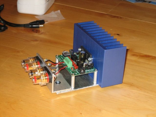

I just threw together an amp6 Basic kit fro 41hz.  I have on a open aluminum chassis and was wondering how you add a safety gnd to this.  the power comes from a 12v wall wort.  Do I not worry about grounding the chassis?

This is what I figured and what I got from DIYaudio.com.  Don't worry about it.  One guy said you can run a wire from the chassis to the ground plug in the wall but I am not worried.
here is a pic sans feet and mute button

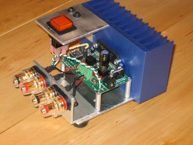

« Reply #14 on: 18 Nov 2008, 01:05 pm »
Couldn't help but post a picture of the amp with its new fancypants mute button.  Does nothing for safety but whatever.  Also a am pissed because I wanted it to only light up when on but it is an always lit type jobby.
