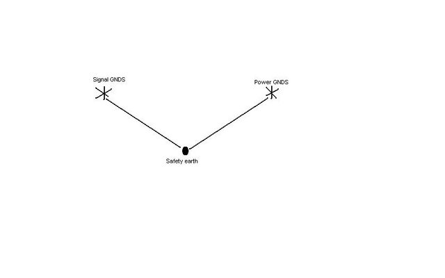

ok so is this how I should would star ground?

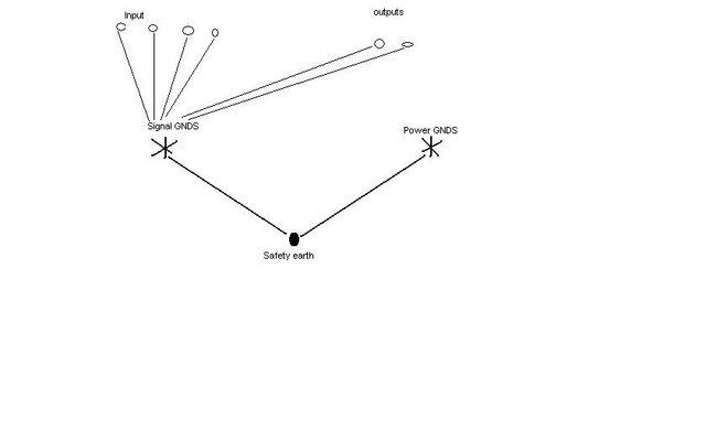

And is this how I I should ground the inputs and outputs with then + going to the source selector?

I'd do it with the signal gnds and power grounds together and then go to safety earth.

I'd make your star ground not touch the chassis, deliberately isolated from the chassis and then run a thick gauge wire from the star ground to the earth ground (that is tied to the chassis) near the power entry.  This way you don't have unintentional currents running through the chassis.  Aluminum is only so-so conductive.  You want to have the currents run through the deliberate wire, not the chassis.

Fantastic!  Thanks for the clarification guys!
IMO, using a resistor (or thermistor as Nelson Pass does) fits the bill better than the thick gauge wire... but as always, experimentation is needed.
JoshK
Re: Safety GND question
« Reply #29 on: 17 Dec 2008, 12:12 am »
I agree, but in terms of the scheme for connecting things I wanted to be a bit more clear.  I typically use the yin/yang diodes in parrallel with a 10w resistor and small cap.
