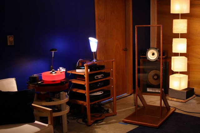

Tell you what, I don't have the "normal" OB arrangement like most around these parts but if you want to experience one that is a bit different, plan a trip out to my house. I live on the other side of Six Flags. Drop me a PM and we can schedule something.

Scott - How do you get those Lowthers to levitate?
It's the magic of 3/4" acrylic  :lol:

Some fancy ass stuff you've got goin' on there, Scott. I'd like to check it out, but a little too far away.

Hi Scott ~
Your OB's are quite beautifully designed... works of art!!!
A nicely thought out solution that must give you a great deal of aesthetic... as well as musical pleasure.
