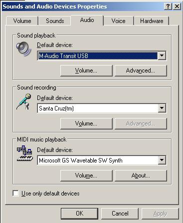

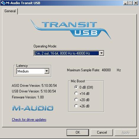

An interesting experiment that costs less than $100 would be to see if using the M-Audio Transit optical output improves the sound. M-Audio wrote its own ASIO drivers.
I use the Transit for my computer based home theater because it can also output a true AC-3 5.1 Dolby Digital signal, unfortunately my AVA Insight DAC does not have an optical input and the Technics SH-AC500D digital surround processor is too low-res for any meaningful comparison.
In Windows, set the default output device to the M-Audio Transit and listen to iTunes and WiMP using the ASIO drivers.

I am not confusing the use of an ASIO driver with ASIO actually being used by the software, everyone knows iTunes and WiMP does not natively support ASIO, this is a workaround or kludge (if you prefer). I tossed it out as a possible experiment and an alternate way to use ASIO with the above mentioned software.
For everyone else: The M-Audio Transit is a outboard devise that connects to a USB port and converts the USB signal to toslink.
I am sure it does not sound as good as Robin's setup.
But in regards to using the M-Audio ASIO drivers with iTunes or WiMP, it can be done and works perfectly.
Wayne
