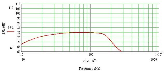

scorpion
Re: 20 Hz to 20 kHz Dipole Speaker System
« Reply #32 on: 24 Sep 2008, 09:58 am »
The wonderful thing with MJK's models is that you can go on simulating and simulating.
Now this is what I will build when the AE IB15s arrive. U-dipole, inner measures 24 x 24 inches, 11 inches deep (corresponding to timber I have at home), a bit more spacious than I thought from the beginning but this is what it will produce with 100 watts input and crossover set to 75 Hz LR 12 dB/oct and +- 7mm cone movement at 30 Hz:
The 1 watt response is like this:
So you see the trade off is rather between side lenght and efficiency than U-lenght and efficiency, calculation is at 32" height and 1 m from U-dipole
/Erling
