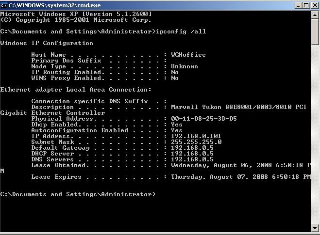

OK. So what is the IP address of the SB3? Do you have any other computers in the house or just this one and the SB3?

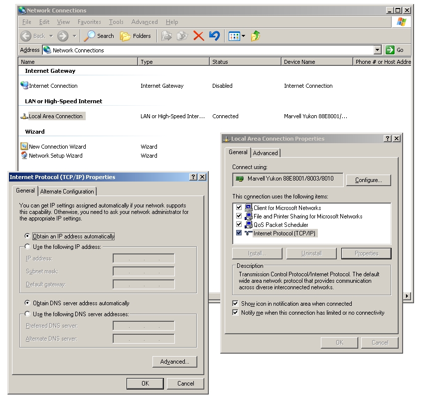

Read about DHCP. Do you know if you normally use it? I'll check the link Rich. Thanks!I don't know if I'm using DHCP or not. Sorry. When you first set up the SB did you type in that IP address manually, 192.168.0.1? Did you set the networking settings on your computer manually? Can't remember if I had to set anything manually. IF MEMORY SERVES... Seting up the SB, Slimserver, and Network was VERY easy. Basically I turned everything on and answered a few questions, but I don't recall addresses being one of the questions. If it were, I would have hit the same brickwall I'm hitting now.I hope this helps and not too confusing. I think this is good information Rich, but it IS confusing. It will take me a few times of reading what you said for it to sink in.
