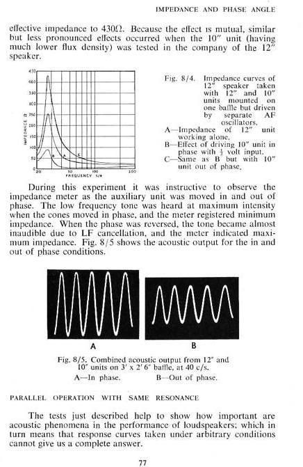

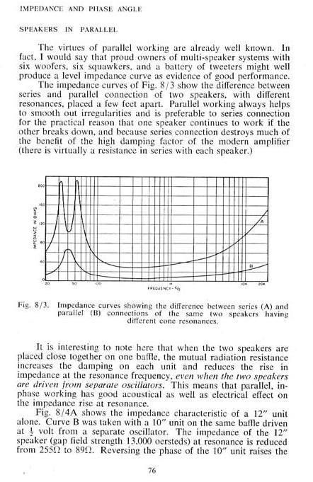

I found out that U frames, as I use, do not have the same SPL level as on a flat, big frame. Then I thought that 2 drivers in parallel could be the answer.
It seems that most people use the same type of woofer, when they use 2 for each side. In the old G. A. Briggs "Loudspeakers" there is a couple af pages describing the benefits of placing two woofers close to each other, if they have a slightly different resonance frequency. It's mainly a question of damping the peaks of the impedance curves.
So, my stupid question is, why aren't there more with different woofers?
I not the best to explain this, so here are the pages in question on the topic "Drivers in parallel":
http://i47.photobucket.com/albums/f199/tubej/Fora/Briggs_1.jpg
http://i47.photobucket.com/albums/f199/tubej/Fora/Briggs_2.jpg
http://i47.photobucket.com/albums/f199/tubej/Fora/Briggs_3.jpg

Hi pufff,
When picking a LF driver I choose the one that seems to be best, and use two of them in parallel if necessary.
I would not go and buy a different one which was less good if LF was my main reuirement.
In G A Briggs' day the LF amplifiers were not like today's very low impedance SS types, and we do not know what the T-S characteristics of his chosen drivers were.  It takes a good low output impedance amplifier to properly energise and control two drivers connected in parallel.

Hi
Not a stupid question at all, I'd say.  At this point I'll assume you're talkiing about a passive multi-way setup.  I think folks use matched woofers because things are more predictable that way.  Efficiencies, displacement limits, etc, guarantee a good match-up.  Graham's thoughts about old vs modern amplification make complete sense, but I still think that your idea could have some benefits from a purely acoustic standpoint, impedance issues aside.
There was some discussion last year in the the (still going strong) "Beyond the Arial" thread over at DIY audio about this very notion.  Lynn Olson didn't think it was a bad idea.  Lampizator's site also mentions that strategic woofer mis-matching can be a good thing.  Both OB, BTW.
The (probable) keys to making it worthwhile would be getting reasonably similar efficiencies, Qts figures, and complimentary (different) response curves.
A lot of preliminary simulations (X-baffle is good enough for this, and it's free) could help you see how driver choices stack-up together.
With a little creativity (like use an inductor on just one woofer) you could balance output, Q, etc & produce a really ideal combined response curve.  Then there's baffle variations. . .  the possibilities are endless, but therein is the fun - the hunt for a holy-grail passive combined response.
You will not likely succeed with the slap-it-in-a-baffle-and-Voila! approach that many favor.  It IS extremely possible to achieve with good homework.

Hmm, I understand the idea of buying 4 similar speakers if they are the best ;-)
The Briggs book is old, but a bit interesting because he started making a dipole using the normal units back in 1956, after he had heard the Quad ELS57. He also used tube amplification, which probably is why he was concerned to have the parallel speakers to work as good as possible. And with a tube amp in the making I'm a bit concerned too.
My bass now is a single 12" in a U frame, and the bottom is a bit weak. My midrange have a 95 db mark. So it is mostly Lampizator style. Or just thrown together  :nono: Anyway, the midrange is wonderful, and I just found the Martin King MathCad models a week ago. So I can build more understanding. And yes, a passive 2 woofer solution in a U frame is what I am seeking, because 2 woofer seems the only solution to get to the 95 db midrange.
