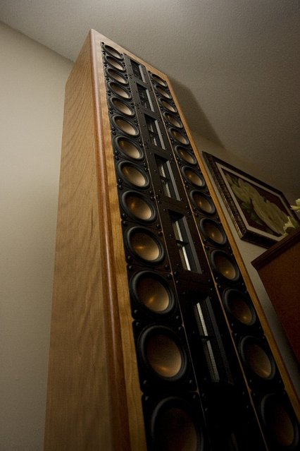

Here's one for the 2008 RMAF. Bases to be added soon...

Rick, think you and I can carry a pair of those around the side of my house?  Hey, I can recruit someone to help us.    I'll get my hedge clippers out and trim up that large shrub.   Should be real easy then.  :)
nice photo!

Those 3" drivers look like HiVi B3S.

You using the NeoPro 5i ribbons in these?
