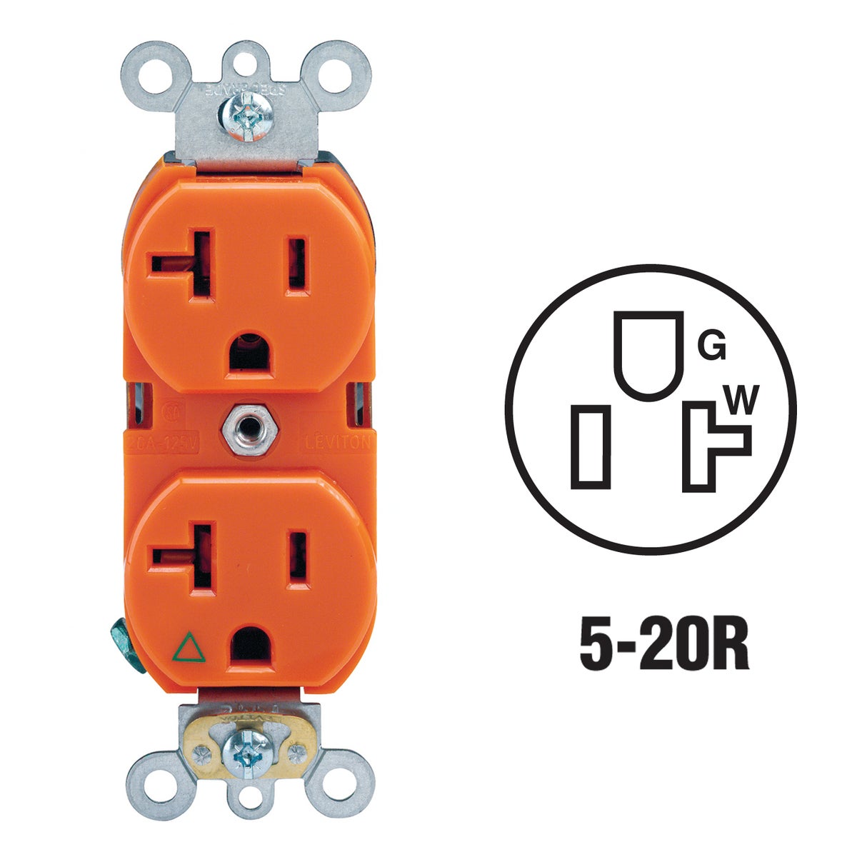

The model pictured below seems to be a pic of the IG8300.  One can identify an isolated ground receptacle by the red triangle.  The green dot means it is a hospital grade.

Lee, could you please expand upon the branch circut?  How about the Leviton?
Thanks much.
cryoparts
Hi,
A "branch circuit" is just a term to describe a new run from the breaker box with one, or more, receptacles connected to it.  Isolated ground receptacle branch circuits generally (though not always) use metal clad Romex.
The Leviton you posted a pic of is an isolated ground receptacle.  Lots of people use them on non-isolated ground branch circuits---but I don't/won't recommend them for that use.  Pretty much anything that starts with an "IG" will be "isolated ground".  IG receptacles will also be orange or red most of the time--though certainly not all of the time, I've seen plenty of other colors.  They will, however, always be identified by the red triangle on their face.
For a much better explanation than I can give about isolated ground circuits, click below:
http://www.iaei.org/subscriber/magazine/06_b/johnston.html
http://ecmweb.com/mag/electric_grounding_vs_bonding_9/index.html
