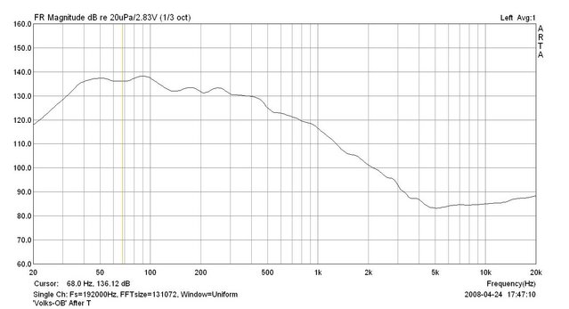

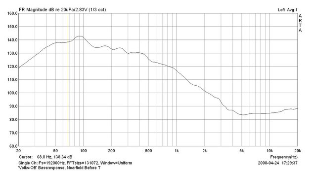

I have tested your circuit with good and bad results. Here are two measurements with the bass unit of my 'Volks-OB'. This speaker has a Qts = 0.73 and fs = 44 Hz so it should be a good candidate for an experiment. The T-circuit is your last published. Measurements are nearfield and with the T inserted after a passive crossover calculated at about 200 Hz with Linkwitz-Riley 12 dB/oct.
First figure is a before T measurement:
The second is the after insertion of T-circuit:
Positive, you does gain some 10 Hz in Bass ! This is an OB speaker and you will go level lower than fs.
Negative, it seems to affect frequency response above the resonance area, rising it. This is unwanted !
Comments ?
Cheers /Erling
Graham Maynard
  • Posts: 274
    • Class-A//AB
Re: Passive LF boost circuit.
« Reply #28 on: 24 Apr 2008, 03:03 pm »
Hi Erling,
Thank you for the technical feedback which supplements my listening observations.
The rise you find around 400Hz is obviously due to some circuit or baffle interection.  I did not hear anything like that here, and the simulator does not show anything either, so I wonder what might be causing this.
Given that this circuit could most suit the likes of the 'Volks-OB' once the R+L+C values have been sorted I should like to look further into this problem.
First though I trust that any other drivers are still being independently driven directly from amplifier output, for this circuit is intended to drive the bass crossover section only.
Possibly a slightly higher choke value would help your application by reducing the frequency at which maximum lift is arising, and maybe an increase in the resistor value in series with the capacitor to reduce the dip around 150Hz.
If the choke you are using happens to be air-core, then it is very easy to increase its value for tuning purposes by doing no more than slip a short length of ferrite rod from a scrap AM radio into the centre hole.  Clip the rod in a clothes peg to hold just the right distance into coil.  Then when you have finished making adjustments, you can measure the inductance and fit an appropriate choke.
Now it might be possible that trying both of these changes will also take out the lift around 400Hz.  If not a possible solution might be a Zobel between input and output of the circuit;  ie.  between the two '+' terminals.  A pure guess first try suggestion here would be 8 ohm + 47uF in series between the '+' terminals.
Looking at your before and after measurements, I am sure you agree there is something of real value to be gained here, and maybe just a little more tweaking to achieve optimum flatness will provide truly rewarding results.
Cheers ............. Graham.

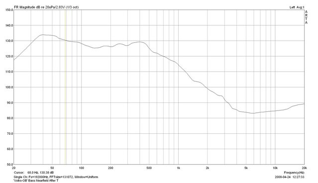

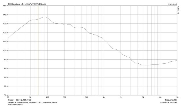

scorpion
« Reply #29 on: 24 Apr 2008, 04:16 pm »
Hi Graham,
You were right. Next measurements, before and after, is taken with T-circuit before crossover. Levels are directly comparable.
1st figure: nearfield before T, 2nd figure: nearfield after T.
Now it is up to the room to support the new low frequencies.
/Erling
Graham Maynard
  • Posts: 274
    • Class-A//AB
« Reply #30 on: 24 Apr 2008, 04:51 pm »
Hi Erling,
From those plots there should be a little more LF gain.
With a large driver on a baffle it might be possible to extend the LF a little more by removing the resistor in series with the choke.
Worth a try !
To me the most notable improvement is in reproduction, the bass becoming deeper and more open at the same time.
How do you find it ?
Cheers ........... Graham.

This is the graph of two 15" drivers, L and R (the two parallelish lines) taken from the listening position, with DEQX's room measurement function. The other line is the equalization that DEQX will apply for as flat an in-room response as possible.
Fs 23 Hz, Qe 0.23.
This is with the inclusion of GRAHAM MAYNARD'S T-BASS CIRCUIT (which I implore people to try).
Now 32 mH 1.5ohms, 747 uF 0.47ohms.
Prior to the T-bass the DEQX showed driver roll-off from about 35-40 Hz.  So I presume the low extension is correct (notwithstanding the inability for dipoles to sustain bass below the room fundamental).  Of course Xmax becomes the limiting factor.
With the room equalization, the bass is very good!  (Next version uses two drivers per side).
Thanks Graham,
David
Graham Maynard
  • Posts: 274
    • Class-A//AB
« Reply #38 on: 1 May 2008, 06:58 am »
Hi David,
I note your component values are now more for extending the LF response with your low Fs driver, and that you have a decent response down to 15Hz !
The original values I show are more for lifting/flattening the LF where there is no EQ and only a simple crossover to a typical Fs=35~40Hz driver.  Actually, I'm not sure what amplitude EQ you are using there.
I am sure you agree though, that adjusting the component values allows useful adjustment to help optimise for both driver choice and room.  Given that you have 1.5 ohms in series with the choke you are not using the maximum LF boost available (which could be used for parties) but which would become noticeable and tiring during quality music listening.
I wonder if that 50>80Hz dip-peak-dip is due to reflection from behind the baffles, and if this might be reduced by placing a vertical board covered in carpet at 45 degrees between each LF driver and wall to deflect the rear output along a wall instead of into a corner/wall and back to the listening position.
