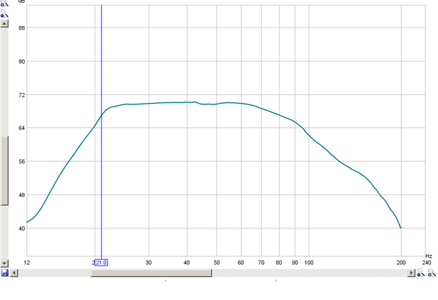

I have built a Linkwitz dipole subwoofer using a pair a PA Audio WN-15R:
http://www.intertechnik.de/index.html/JTI2bmF2aWQlM0QxNzY4JTI2bGFuZyUzRGRlJTI2c2lkJTNEbjQ4MWRmMjAxOTdjYzMlMjZiJTNE.html?detail=45955
I choose this driver because it has a relatively low moving mass (66 g) and  a good BL/Mms ratio (about 0.24). I am using the subwoofer for nearfield listening for frequencies below 80 Hz.
 I have measured the  FR  at the listening position: flat down to 15 Hz with equalization (Reckhorn B1). I am not happy with the sound: bass is  too slow, not detailed, not involving.   I am using a digital amp (Sharp SMSX1) and very short thick speaker cables (R <= 0.1 Ohms).
I have now to take back what I wrote above. The problem was the low pass filter I used. It was not steep enough and let too much sound above 100  Hz pass through. The Reckorn B1 has a poor low pass filter. I solved the problem by using the subwoofer output of a HT receiver.
This is the frequency response of the W sub at the listening position with boost applied (sub is placed just behind the sofa):
The -3 db point is 21 Hz.  The FR is almost perfectly flat, but that is just luck.  The rapid drop below 20 Hz is partially due to the subsonic filter of the B1.  Bass is very tight and extended and dynamic. It sounds very good. There is no room interactions. The sub does not vibrate. The woofers barely move.
I don't plan to add Graham's circuit at this point because the frequency of resonance of the woofers in this W frame is too low (26-27 Hz).
Bruno
