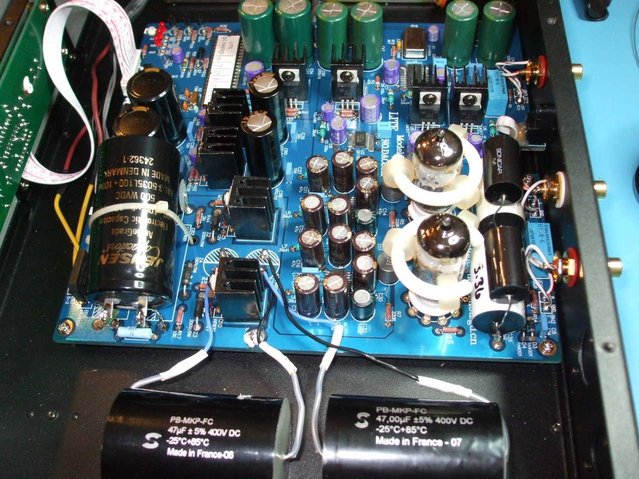

As far as the DAC-60 being hard on tubes,  notice the mod I posted raises the plate and cathode resistors to 300 ohm.  This lowers the bias current flowing thru the tubes.  The stock 100 ohm resistors are much lower (higher current)  than about any design I have seen.

I replaced the output caps with 5 uF paper-in-oils.  I also have a choke to replace the CRC resistor but I am on the fence as to wether I should install it.  It would be before the mofset so I am not sure it would help,  also I know that if the choke isn't of the correct value it could screw up the B+ and add ripple.  I have seen reports where the choke is a big improvement though.

Off to the side,  these are the $7 Sprague paper-in-oil caps from Nebraska surplus that get glowing reviews.
Make sure when you do any mod on this to leave it unplugged a few days so the caps discharge,  the CRC caps hold voltage for a long time.

The last mods I did were to change out the CRC caps and the 470 uf caps in the dac chip power supply. I hadn't used the dac in 5 days, (still plugged in but turned off). The 120 uf caps were holding 18V and I discharged them with a resistor. I replaced them with Nichicon 100 uf. I replaced the 47 uf electrolytics with Solen poly and the 470 uf with Blackgates. Sweetened up the top end. Next up is a Jensen 100 + 100 instead of the Nichicons and Multicap .1 uf to replace all the little blue 104 caps in the dac chip power supply.

Parts Connexion. #68081. Expensive little sucker though, $62.25. I just recieved it on Thurs. and measured it. Perfectly matched sections @ 117 uf per side. I'm going to try to get at it this afternoon.

I take it that a single Jenson dual is replacing the two CRC 120 uF Silmic caps ?

markC
Re: DAC60 vs. Benchmark vs. PS Audio Link III
« Reply #97 on: 27 Apr 2008, 02:15 pm »
http://www.audiocircle.com/image.php?id=14229
Here is a pic of my lastest mods completed just last night.
