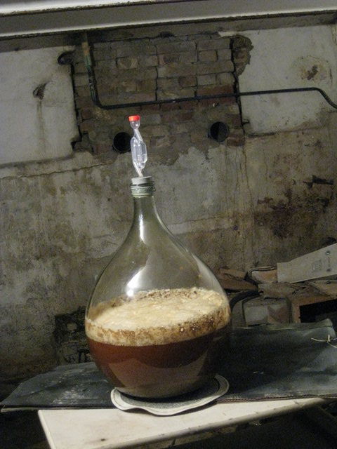

« Reply #31 on: 5 Feb 2009, 04:01 pm »
well slowly my experience rises
best i learned is how much the kind of yeast influences the taste and don't ferment above 22,5 degrees Celsius
as some yeast produce the banana ester near and above that temperature. A taste which I  detest in beer
Also i learned to take wheat from commercial brands out of the bottles
you can buy in  shops. My number one beer is West Malle triple a Belgian beer
with living wheat in the bottle. Very fine beer
The beer i made is not close at all to it as i have a random recipe, not Tailored  yet
to a specific taste. First i learn the mechanics
here a picture of my current 1st fermentation process this is the second  day and already the layer of foam is getting less. temp is around 19 degrees C
BobM
Re: making beer at home the easy way
« Reply #32 on: 5 Feb 2009, 04:55 pm »
Way too much air in that bottle - fill-er-up!!!
And wrap a towel around it when it is fermenting to keep the temperature consistent and the light out. Light bad - dark good, that's why home brewers use brown bottles and not clear ones.
Enjoy,
Bob
Wayne1
« Reply #33 on: 5 Feb 2009, 07:40 pm »
Hello BobM and kyrill,
Airspace doesn't matter in a fermenter. The CO2 given off by the yeast will displace the air and keep the fermenting beer safe.
The airlock will allow the CO2 to escape and prevent air from coming back in.
Wrapping a wet towel around the carboy is a good idea. Keep one end in a bucket of water so that evaporation will help maintain constant temps.
The banana/clove ester that is common in German wheat beers is from a particular strain of yeast. Using a "standard" ale yeast, properly hydrated and active will prevent those flavors from developing. 18-20 C is the best temp to ferment most ale strains.

kyrill
« Reply #36 on: 5 Feb 2009, 09:48 pm »
Oh I love you all
self made organic rich tone, 3D deep, no electronic mass market flavor, real live
and live real
YESSZZ   :thumb:
thx for the advices and support
becoz of the photo i made i had the light on in the cellar
i mean look at the back ground, this is NOT my living room or kitchen :)
So when i left it will be pitch black
the room has a very steady temperature but it will do no harm to cover the bottle
with its own coat. I will
kyrill
« Reply #37 on: 7 Feb 2009, 04:07 pm »
This is the 3rd day of fermentation and i never had so much foam? What does it mean?
what happened with the picture?
« Last Edit: 27 Mar 2009, 05:07 pm by kyrill »
Wayne1
« Reply #38 on: 7 Feb 2009, 04:22 pm »
It means you have some mighty happy yeastie beasties  :wink:
The yeast is eating away at the sugars and reproducing and producing alcohol and CO2
The large quantity of foam, called krausen, is just indicitve of a very healthy fermentation.
That is one reason to ferment in large containers. To allow the krausen to form and not clog the airlock.
Another method is to use a smaller container with a blow-off tube into a bucket to contain the expelled krausen.
