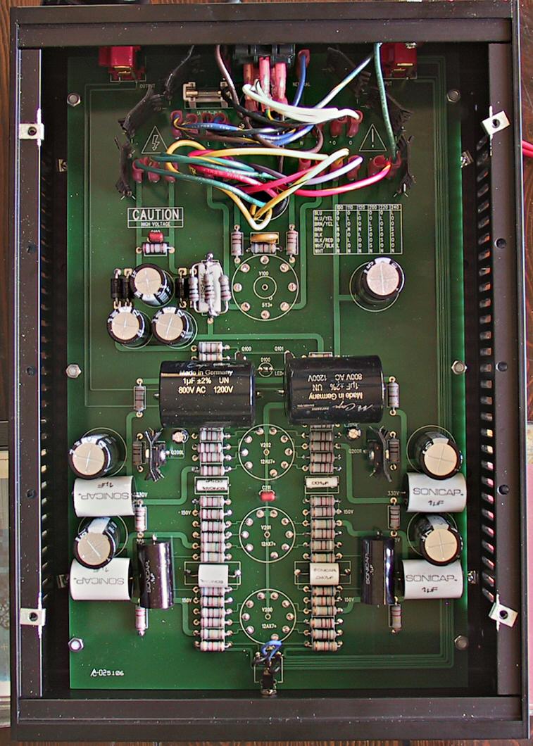

I am gathering parts for a Cornet 2, and I am wondering about the signal cap upgrades that people have tried. I have a couple of .1uf Russian Teflons that I will try to shoehorn in, but what about the 1uf's?

I went with all Sonicaps in mine. I think that was a pretty popular choice - not too pricy and very good sound.

Did you use the 200v or 600v? Sonic Craft says they are tested at twice the rated voltage.

Sonicap Gen1's are a good choice. Following the lead of others I used a Sonicap Platinum at C203 and plopped in a big fat 1 uF Mundorf Silver/Oil at C208 and have no thoughts of any further upgrades, this is probably as good as it gets.
The Sonicap Gen1's I used were 400VDC, same as the caps on the parts list. I would not go lower because you have 330VDC in places.
In the photo below notice all the resistors hugging R223, these lower the resistance so heater voltage is at spec, 6.3 volts, with the rectifier tube I am using. Adjusting the heater voltage to spec also improves the sound. There is a thread here explaining the process and calculations:
http://www.audiocircle.com/index.php?topic=41430.0
