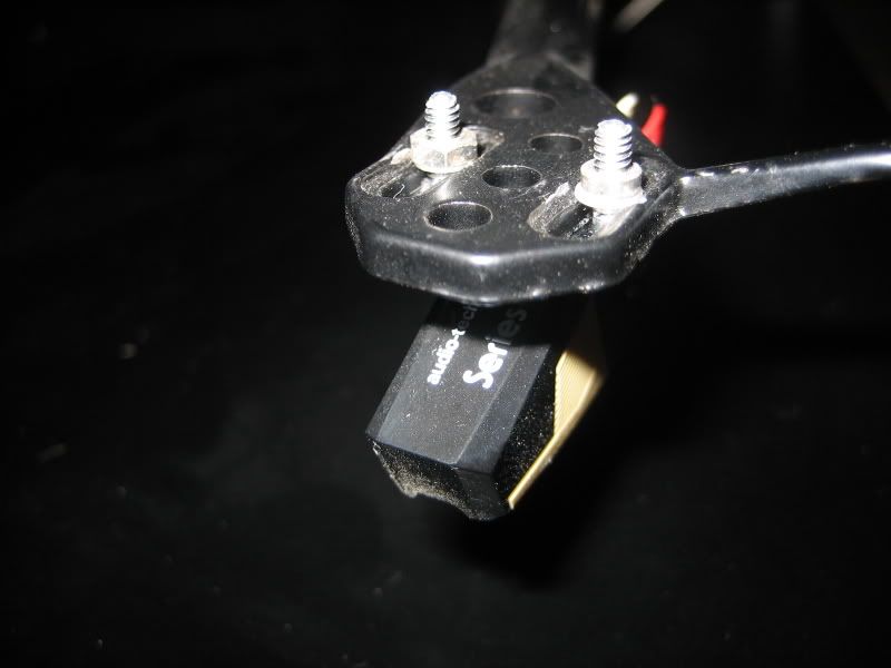

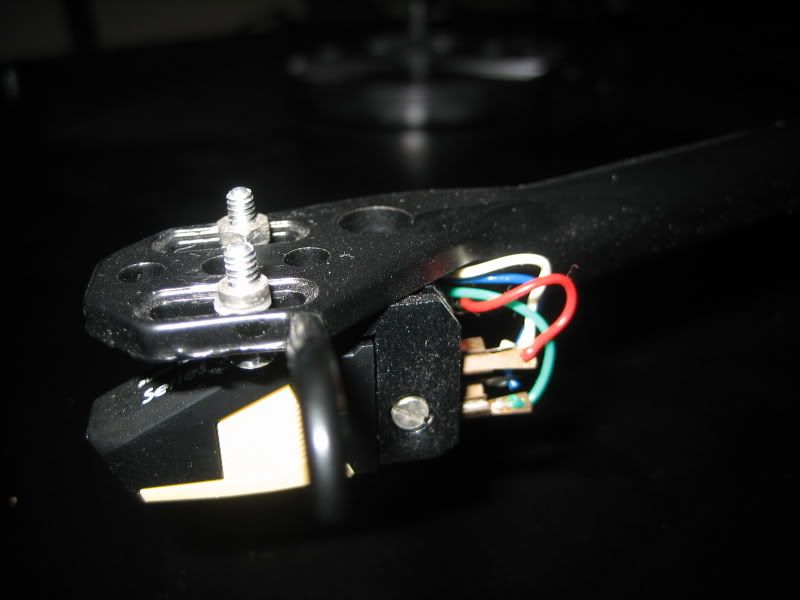

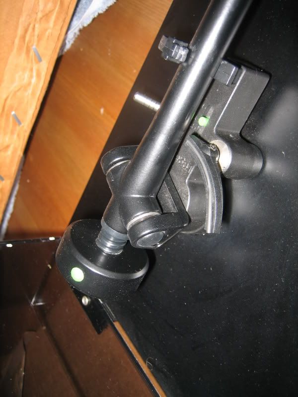

Well it's kind of a long story but here goes. It all started one day when my wife's dad asked her if she wanted his old records from 20+ years ago. I said "hell yeah" so he went off to storage and gave us all of his records as well as his old Technics SL-B2 TT. Now the TT was in very bad shape and it was going to cost me over $100 to get it working and was about to pull the trigger when I found an ad on craigslist of some Epos ELS-3 speakers and Rega Planar 2 TT w/ RB250 arm. Well I paid $450 for both the TT, speakers and also matching stands which by themselves are $200. The TT was in absolute pristine condition and looks brand new as well as the speakers. It was an older man who loved his gear but was moving so had to sell all of it. For right now I am using a 6 year old Sony 5.1 receiver with a Bellari vp129 phono preamp. The cart on the TT is an old AT series V that sounds good, although output is pretty low. My wife said I could upgrade little by little so in 6 months I am planning on spending around $1200 on a nice tube preamp and SS amp. I have been looking at the Ming Da MC 7R tube preamp paired with a high current amp like a Rotel RB1070. Then a year after that splurging on some better speakers (~$2000) and I will be set which what I think would be a great system. (not audiophile I guess but still decent)
I plan on keeping the TT for a very long time as it is in great shape and I think I can get a lot more out of it with a nicer cartridge and possibly upgrade the arm to an RB300 if I can find a good deal on a used one. So now I am in search of a good cartridge that I will have for a long time and I was looking at the Grado Gold ($180). Is there another cartridge out there you guys would recommend at this price range that would work better with my TT and possibly an RB300 arm? Keep in mind this is my first entry into vinyl so I really know nothing about cartridges and how they sound. I keep hearing that Grado's tend to have a warmer sound which I am guessing I would like as I can't stand bright speakers. I like clear, smooth detailed midrange and non-bright sound.
BTW this is a picture of the TT so if you guys could identify the cartridge and tell me if the TT actually has an RB250 arm that way it would be great. I compared the pictures on the Rega site and it looks like it to me but you never know. Thanks

Looks like a RB300 arm to me, the same one I have!  :D
I used a Denon 103R cart to good effect but when I sold my preamp, I had to go for a higher gain cart and settled for the Dynavector 20XH. That took the music to a higher level!

Chatted with a friend of mine. He is a Rega tonearm expert. He tells me that the Rega 300 tonearm has calibrations, which you should find on the right-hand side of the tonearm. If it does not have those calibrations for fine tuning of the arm, then its likely to be a RB250. I cannot tell from your photos except to say that it sure looks very much like a RB300 from the angle of your shots.
He went on to say that sonically the two tonearms sound almost indistinguishable!

It's an RB250 - pretty sure at least.  The plastic end stub is the giveaway....the RB300 has a steel end stub.
Keep the RB250...it's actually a better arm once (slightly) modded.  The biggest change would be the end stub and counterweight.  Lotsa' folks sell upgrades to it - Kerry Audio, Michell, Origin Live - they all work to greater or lesser degrees (better bass, higher resolution, etc) at under $200.00.
I don't find my Grado to sound special in my Rega 250 arm (with upgrades)...Grado's really need fluid damped arms to sound right (or damping the cartridge body, coils and tonearm itself to 'mimic' some the damping effects of fluid damping)
Not many cartridges sound too bright in the Rega arms....they tend to sound 'dark' in general.  It's slightly on the light side, so some moving coils might sound a bit etched. Someone explained to me that it is likely the black powder coat finish giving it a dark tonality...but I don't know (folks do remove the powder coat finish sometimes, but I have not)

that is definitely an rb250, not an rb300.  the 300 has mounting support on one side, only, not two sides.  (and calibration marks, as prewiously mentioned.)  but do not fret, instead of "upgrading" to an rb300, yust get your arm upgraded by origin-live.  an o-l modded rb250 will outperform even an o-l modded rb900, let alone an rb300.  and, this is per o-l.  the reason being that, after upgrades, the mounting support on both sides of the arm is superior than a single-sided support, even tho the bearings aren't quite as good...
re: reasonably priced cartridges, i am partial to ortofons.  i'd look for something like the mc3 or better.  ortofon makes excellent hi-output mc's and mm cartridges.  if you're careful, you could go up a model or three, if you buy used, but you should really trust the seller, if buying a used fono cartridge.  also, i would recommend getting a "fine-line" type stylus or better; i would stay away from any elliptical or spherical shaped styli...  much better tracking & less record wear w/the new stylus types.
now, when you're ready to upgrade the turntable itself, for ~$150-$300 or so (depending on the ebay feeding frenzy at the time, & actual condition of the turntable), you should investigate the early unsuspended empire's.  these are competitive, imo, w/any modern deck at multiple times the cost, & a big upgrade over the rega's...  and, it's an easy retrofit to install a rega tonearm on an unsuspended empire.
